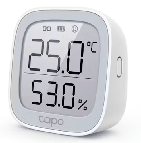

SENSOR Change:
Hi - I eventually got around to replacing an older Xiaomi bluetooth sensor with the sub 1Ghz one below from Tapo. Works perfectly with this automation.
@sota
