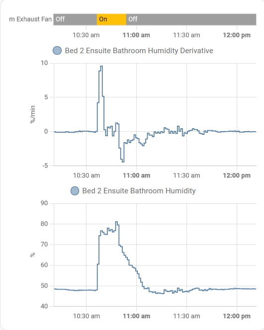

Automation seems to be working great turning the fan on but it doesnt seem to be turning the fan off. I simply just want to use the falling % and a simple delay. What am i missing?
alias: Bathroom Humidity Exhaust Fan
description: ""
use_blueprint:
  path: Blackshome/bathroom-humidity-exhaust-fan.yaml
  input:
    trigger: sensor.bathroom_humidity_derivative
    fan_speed_low: []
    fan_switch:
      entity_id: switch.bathroom_fan
    time_out: 60
    include_max_humidity: maximum_humidity_enabled
    max_humidity: 70
    bathroom_humidity_sensor: sensor.bathroom_temperature_sensor_humidity
    time_delay: 30
    falling_humidity: -1.5
@hauser123
Your Maximum Humidity is very low. This option is mainly designed for situations like when one person finishes a shower and another starts soon after causing humidity to rise again. I have mine on 85% for summer and 87% for winter.
For your time delay of 30 and safeguard of 60. I have 7.5 for summer with a safeguard of 17 and 15 for winter with a safeguard of 20.
First try and disable the Maximum Humidity Option. Test it and see if it all works well.
Then when that works have one shower, let it finish, then start another shortly after… see what the humidity does. Use the high end of your humidity levels of your 2nd shower to set the Maximum Humidity Option. It’s not meant to trigger the automation ON when the humidity goes from below 70 to above 70 without having a shower. Is designed for what happens when we have the 2nd shower, humidity drops a bit then rises again and the Derivative Sensor wont trigger it back ON because the move is to low.

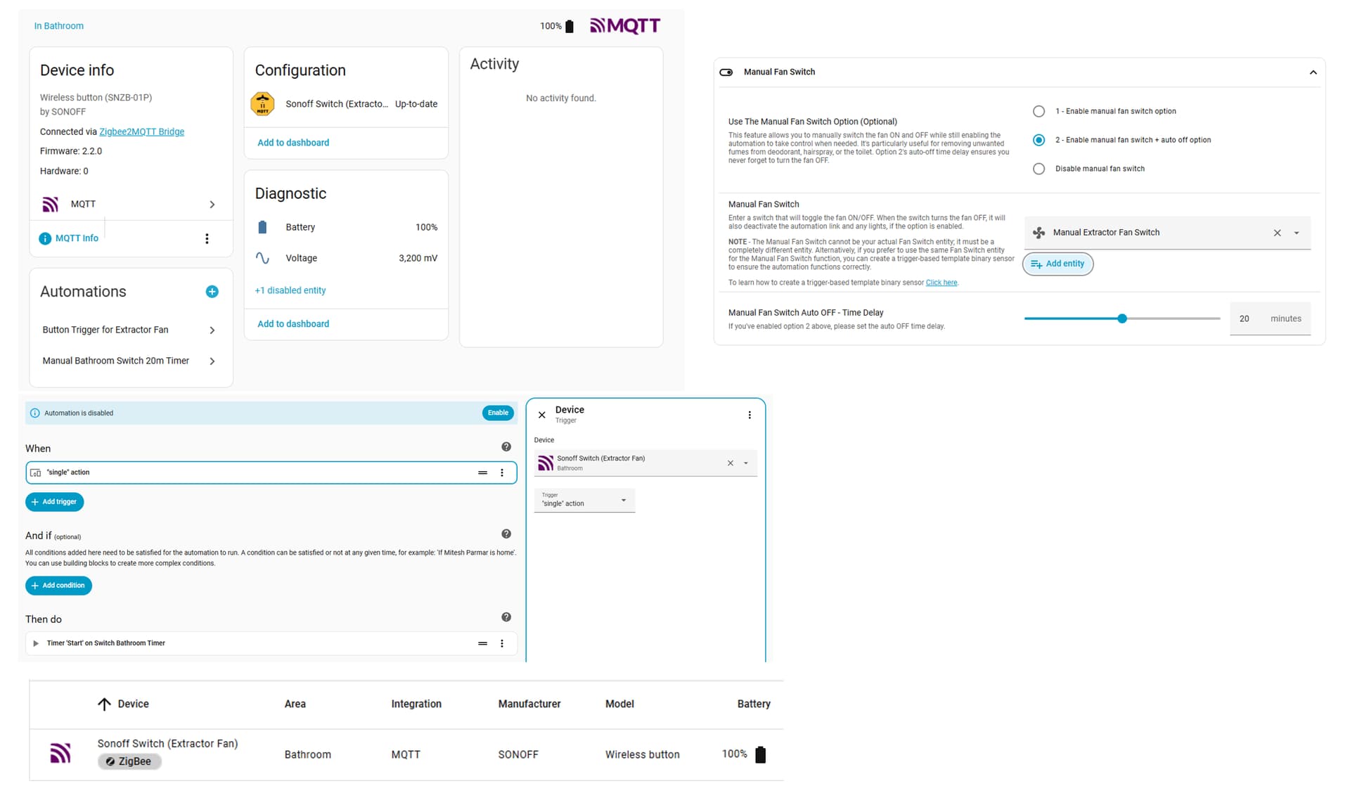

Hi @Blacky, first of all, love this blueprint, the main reason for setting up HA was mainly for this bathroom extractor fan to come on only when needed. So thanks!
I have recently bought the Sonoff SNZB-01P wireless button to use as a manual trigger for when guests of the toilet may wish to turn on the fan. :poop:
But it does not show up in the trigger list.
I do have a helper I use as a manual trigger, and wanted to add an additional entity for this.
If I try setting up my own automation, I can add the button and switch the fan ON/OFF, but there is no timer, so in theory this could run until pressed again. (I also looked at your timer blueprint, but same thing, cannot find on the list)
Ideally, wanted to use the button to switch on the fan, if not pressed again time out after 20min. If pressed during the timer then switch the fan off.
The Sonoff button has single, double, and hold setting. I’m just trying to use the single press for now.
Appreciate any help. I’m fairly new to HA. :slightly_smiling_face:
Thank you.
I have Version: 2.6 installed of your blueprint.
@MitMit
Welcome to the community. Yeah this is one of my favorite blueprints too.
This helper your referring to would probably be a toggle helper. What you can do is download my :nazar_amulet: Press Button - Turn ON & OFF Entities blueprint. Use the button in the Press Button and then use your toggle helper as the Main Entity. That is if you like the button to trigger the Manual Trigger. If you would like it to trigger the Manual Fan Switch then just creat a diffrent toggle helper and use it in the Main Entity of the press button blueprint and then use that toggle helper in the Manual Fan Switch.
