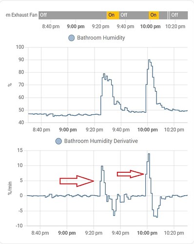

Hi thanks for everything. Can you help me out here, I don’t quite understand the numeric part in the faq. Specifically -
“ 1. The first shower’s initial increase is just below +5.0, and the ending is just above -5.0.
2. The second shower’s initial increase is around +7.0, and the ending is just above -5.0.”
In the derivative graph during the first shower it jump from 0% to 10%. But in your sentence it says +5. I’m sure the problem is me as I’m not understanding something somewhere, help me out please? :slight_smile:
@1a2a3a1q2s3c
It is the first jump (step) in the reading. Good to catch it on the first jump and trigger the automation.
Hope this helps you.
Blacky :grinning:
