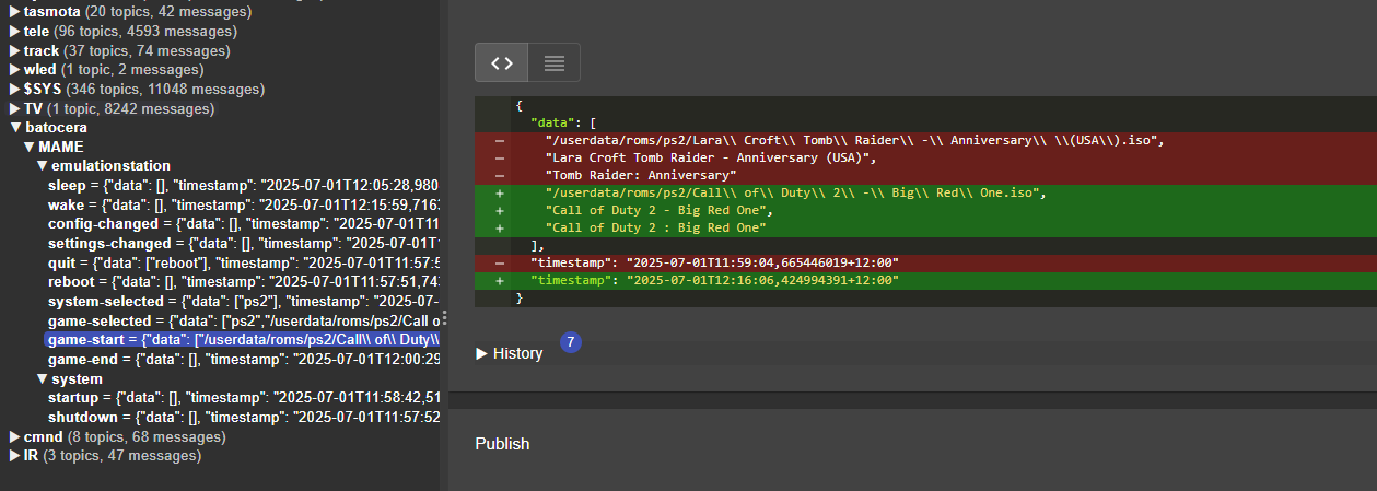

after a reboot of the batocera box
I look into mqtt explorer I see
one Happy camper here

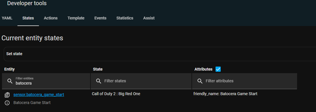

as I want to know the game-start
old school here love YAML

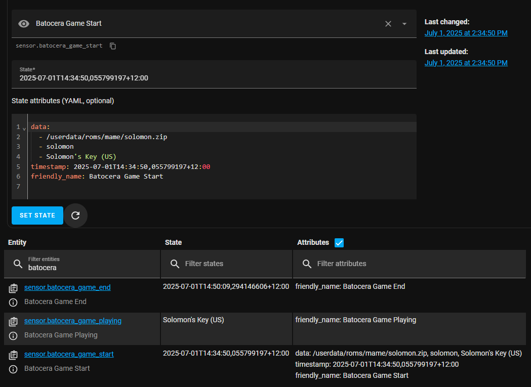

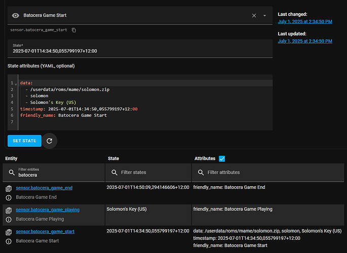

so in my mqtt sensor config i have
  - name: "Batocera Game Start"
    state_topic: "batocera/MAME/emulationstation/game-start"
    value_template: "{{value_json.data[2]}}"
as all data coming in is json format I want to read the game name
as its the 3 one in the array
I can read that value
I get this in my sensor

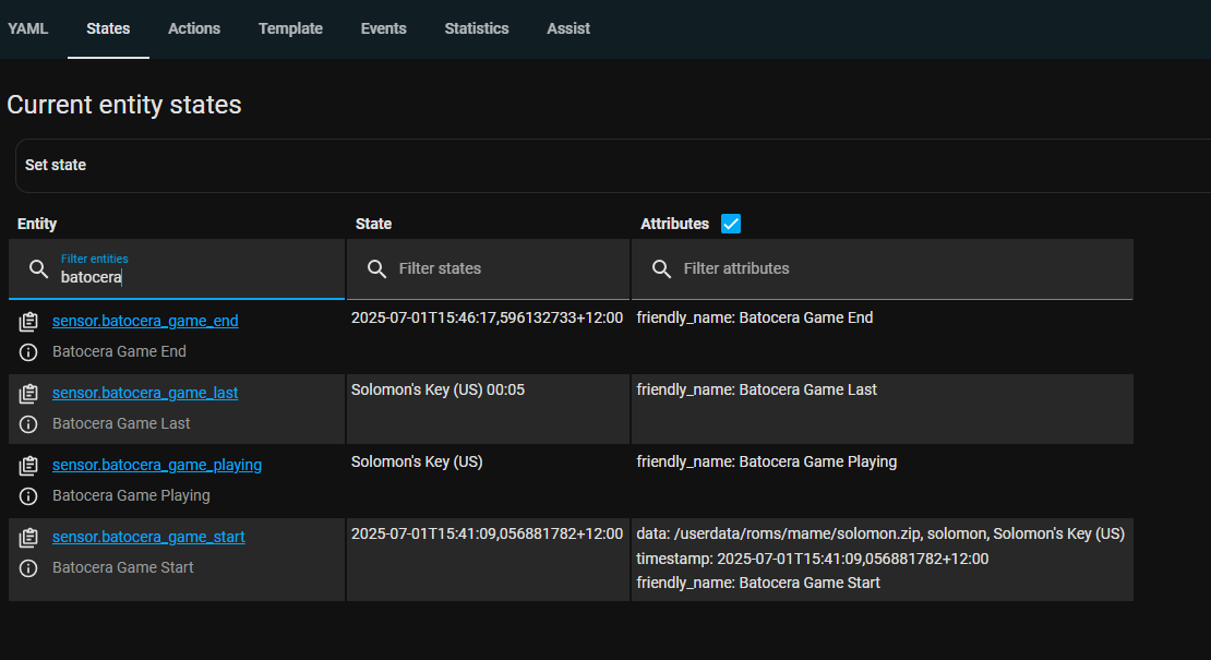

Now the maths part work out playing time
Got it working adding watching the state change of the “sensor.batocera_game_end”
can do the maths on sensor.batocera_game_end - sensor.batocera_game_start
- trigger:
    - trigger: state
      entity_id:
        - sensor.batocera_game_end
  sensor:
    - name: Batocera Game Last
      unique_id: 6f8bb9d7-6f60-4b85-8645-8a70118ccf6e
      state: >-
        {%set s = states.sensor.batocera_game_start.state | as_datetime | as_local %}
        {%set e = states.sensor.batocera_game_end.state | as_datetime | as_local %}
        {%set n = states.sensor.batocera_game_playing.state %}
        {%set l = (e-s).total_seconds()  %}
        {% if e>s %}
        {{n}}  {{ l | timestamp_custom('%H:%M', false) }}
        {%else%}
        {%endif %}
