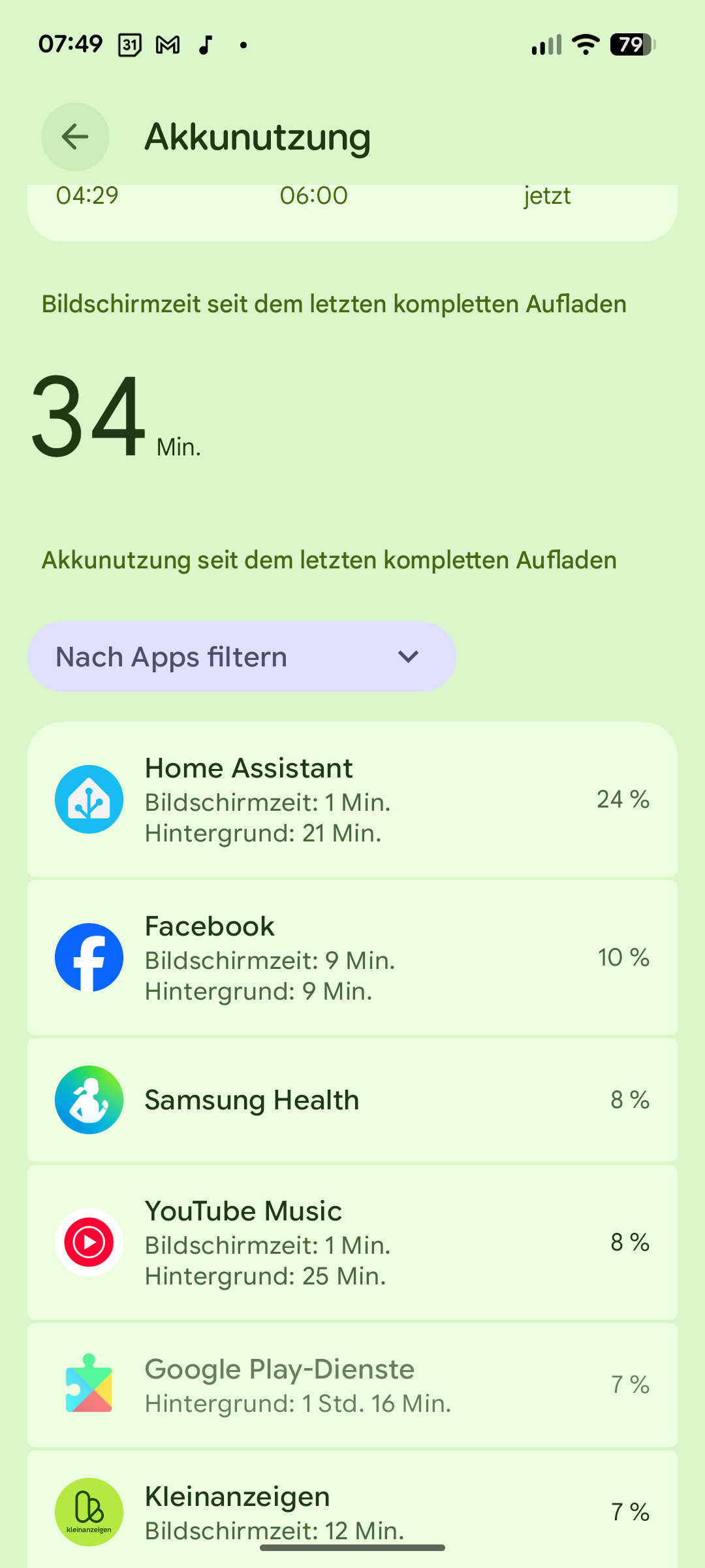

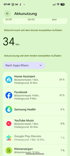

I don’t know if this has been the case for a while or if battery consumption only increased so significantly with Android 16. But at least since Android 16, I’ve noticed that the battery drains very quickly. Then I noticed that Home Assistant uses 24% battery. Is this normal or very high? What about you? I deactivated location sensors and Health Connect sensors for testing and left only my alarm sensor active, but this made no difference. I deactivated persistent connection. Notifications are delivered via Google.

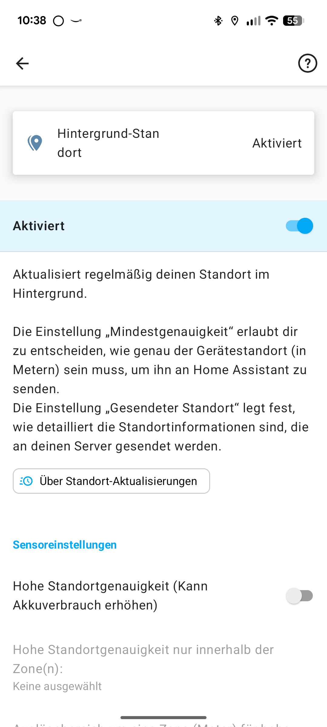

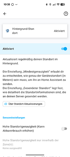

  1. If on the full version check that high accuracy mode is not left enabled all the time. Yes

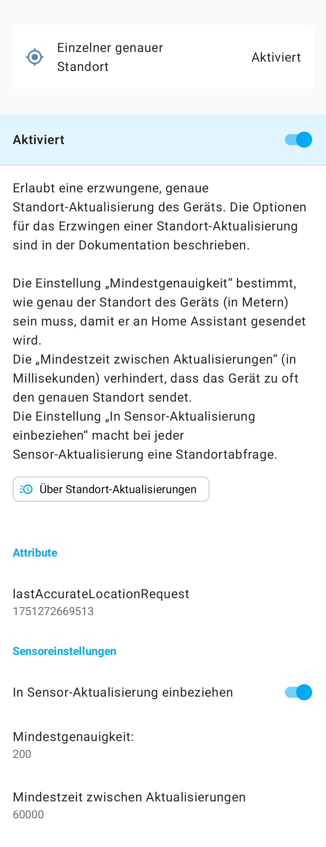

2.If on the full version check that Single Accurate Location sensor does not have “Include in sensor updates” option enabled. Yes

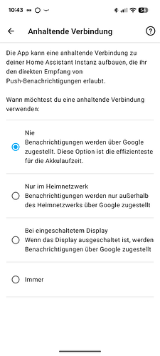

  1. Check that Persistent Connection is set to “Never”. Yes

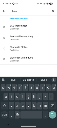

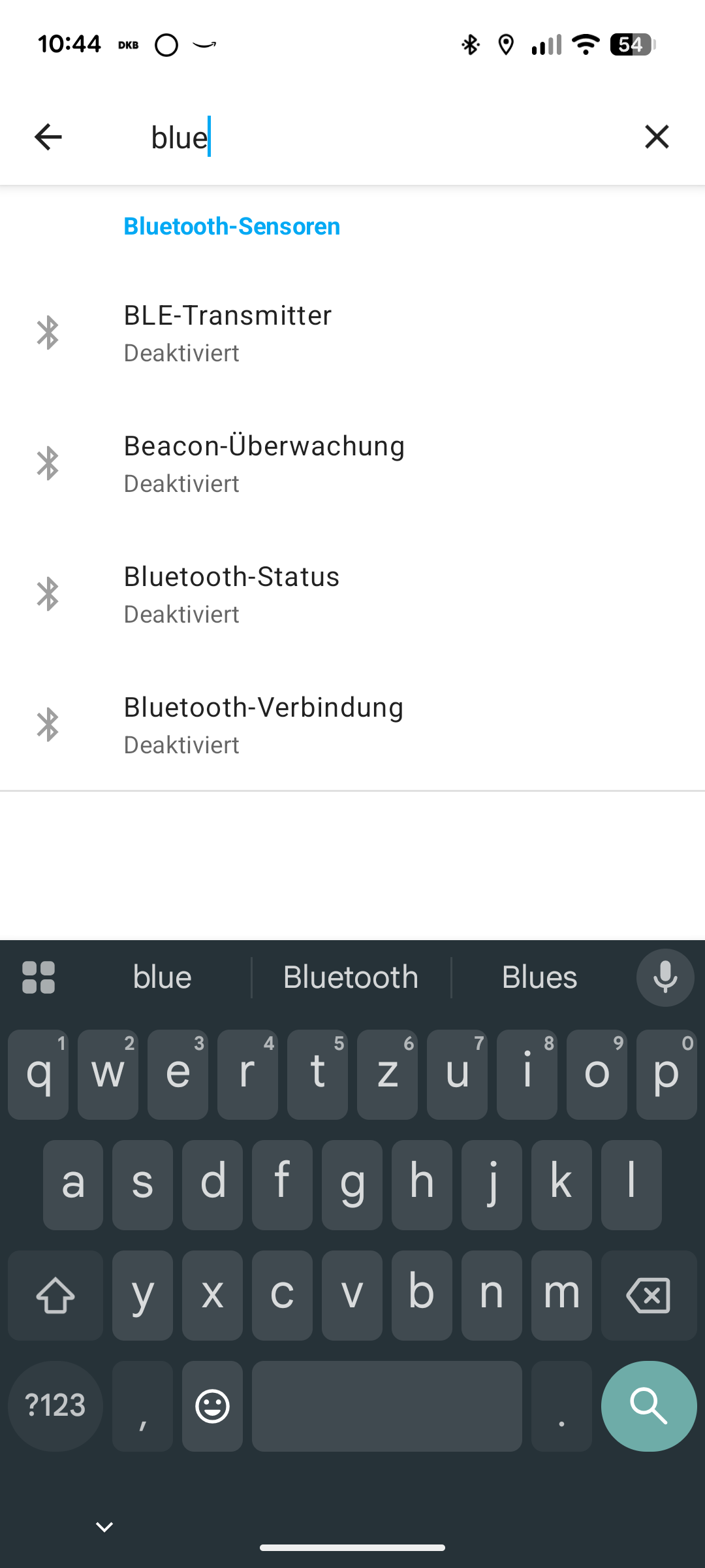

  2. If the Bluetooth Transmitter sensor is enabled check that the transmitter is not left on all the time, only enable it when you wish to use it. Yes

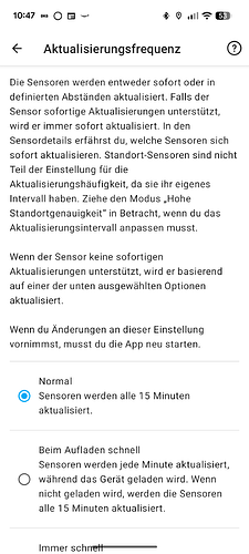

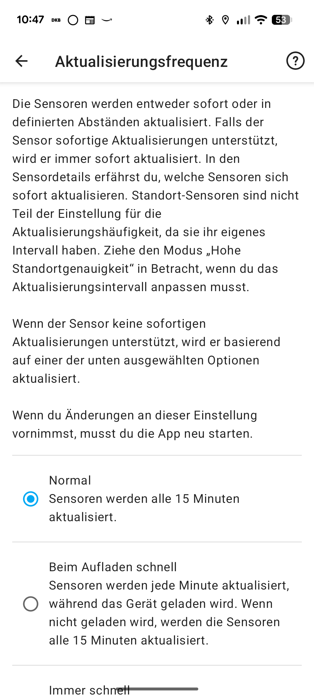

  3. Check that Sensor Update Frequency is set to “Normal”. Yes

    Yes, all Notification Sensors deactived

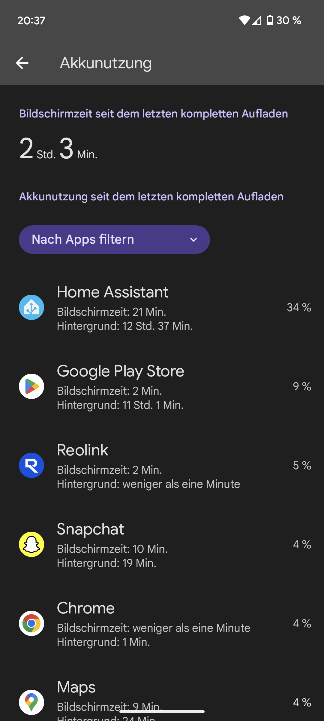

For my wife and me the battery usage is also crazy high. We both have a Pixel 7 and it uses >30% of the battery.
I checked the settings (ours are on default with no fancy tracking etc.) and I have seen nothing that I could really turn off.
Both are running Android 16.
