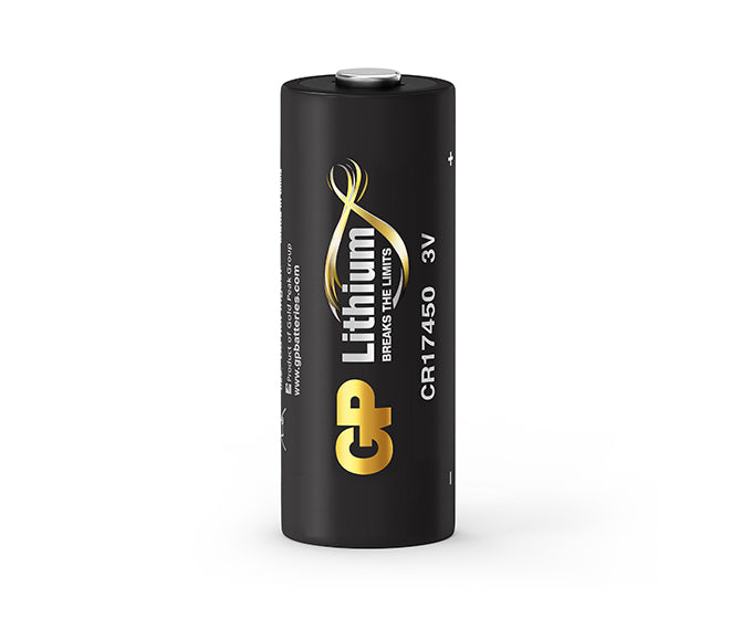

Anyways, I can do that of course - is there any brand that is specifically good for CR17450 batteries?
yes,
The main reason that most batteries that come with devices tend to crap out early then they are meant is usually due to the difference between them being manufactured and then put in to storage to be sold.
It’s usually best practice to just let them be used up then replace it new ones.
For most batteries here in australia I usually go with energizer branded ones as they tend to last the longest even with regular usage if they have the type avaliable.
Looks like here we mainly have these brands to work with for those CR17450 batteries:
https://www.voltexelectrical.com.au/p-4594-lithium-battery-3v-cr17450-for-voltex-smoke-alarms-only-suitable-for-old-model-sas135mh-w.aspx
Everything else I see listed is the generic ones or from a brand like Eve.
