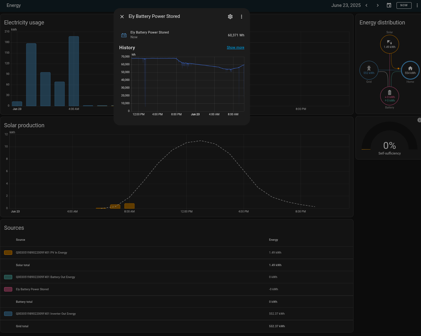

I’ve got a number of batteries that I consolidated into a helper that shows Wh stored… I added that to the energy dashboard and it shows if I click on it but doesn’t show in the dashboard itself? See screenshot below…
Am I doing something wrong such that the Wh aren’t being shown or is this a bug somewhere?

Energy dashboard does not do anything with the level of stored energy in the battery.
It wants an always-increasing sensor for the amount of kWh going into the battery, and another always-increasing sensor representing the amount going out. It will not report the current charge of the battery.
The sensor you have there doesn’t look right for the dashboard (it is going up and down), and will probably yield incorrect results.
