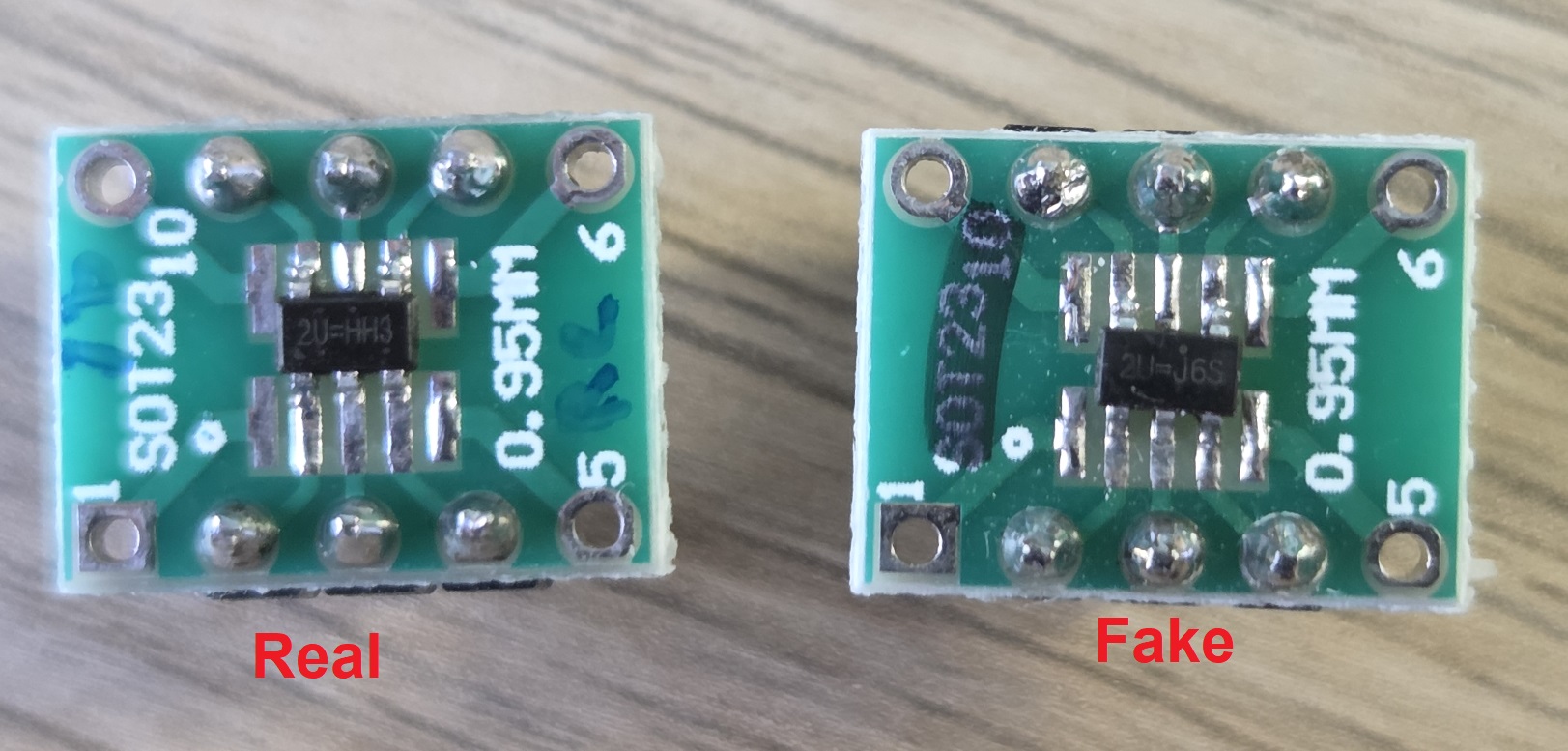

I finally found some time to test the genuine RT9080 from Digikey. To the surprise of absolutely nobody, I can now confirm that I was indeed scammed by AliExpress.
I did the exact same experiment as when I initially tested the fake components, and repeated the test for both of them today in exactly the same conditions. The results speak for themselves:
  • Genuine RT9080’s quiescent current: ~2uA
  • Fake Aliexpress RT9080’s quiescent current: ~80uA
Here’s a photo of both components, for reference:
The real part is marked 2U=HH3, the fake one is marked 2U=J6S
And here is the listing for the fake part, do NOT buy if you’re looking for a low quiescent current part: https://de.aliexpress.com/item/1005009348334551.html
You live, you learn :slight_smile:
