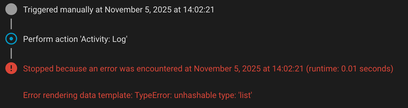

hi Ltek, just tried this blueprint, almost setup nothing but I get the following error:
I just updated the Blueprint as I found a bug in the To-Do list code… see if it works for you now. If not, please report back provide a screenshot and a log entry with the error. thx
hi, sorry for the late response. didn’t get the time to troubleshoot the previous reported issue but I just reimported your new blueprint and it runs without issues now. Thanks!

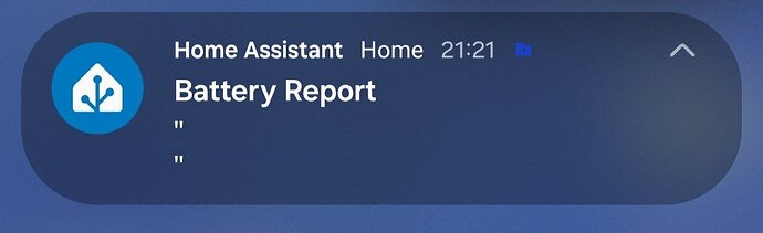

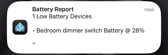

I’ve been having issues with notification messages having a line with just two single quotes in the end:
I looked into your code and applied simple fixes to all the problematic locations in there.
You can find my patched version here.
A diff is available here. It doesn’t look great because of the number of very long lines in the code. Let me know if you need any explanations on the edits I’ve made.

update posted…
:rocket: Version 2026.02.12.12c
- Added: Independent To-Do List options (Entity IDs, Friendly Names, Both)
- Fixed: Stray quotes appearing in notification fallback messages
- Fixed: custom_group_combined empty-check when both sensor groups are empty
- Recent Fix: To-Do list and No-Issues Confirmation messages

@konstantin-kelemen thank you for showing me that. I found some other related bugs that can cause that issues. Update, I hope, fixes all those situations. LMK
Thank you!
Works great :slight_smile:
