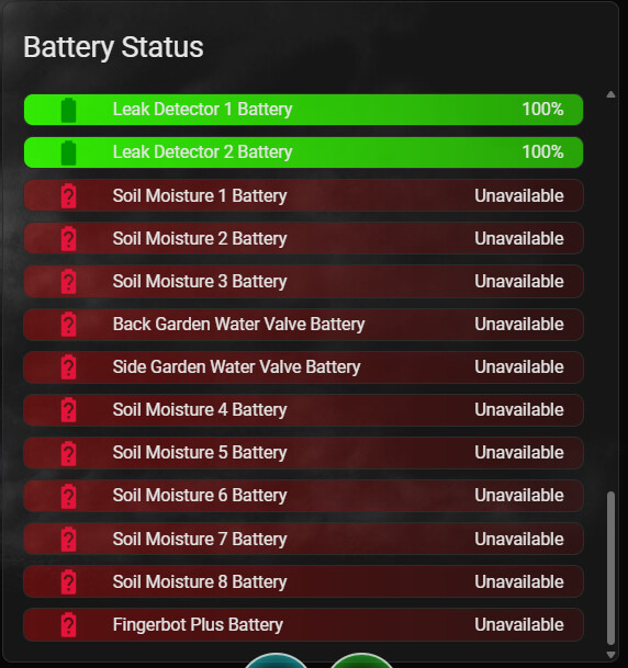

I does not pick up on unavailable batteries though. Will raise an issue on git.

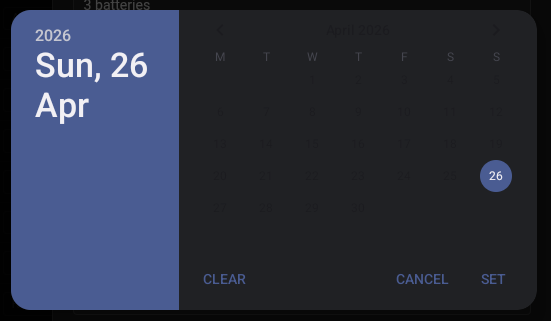

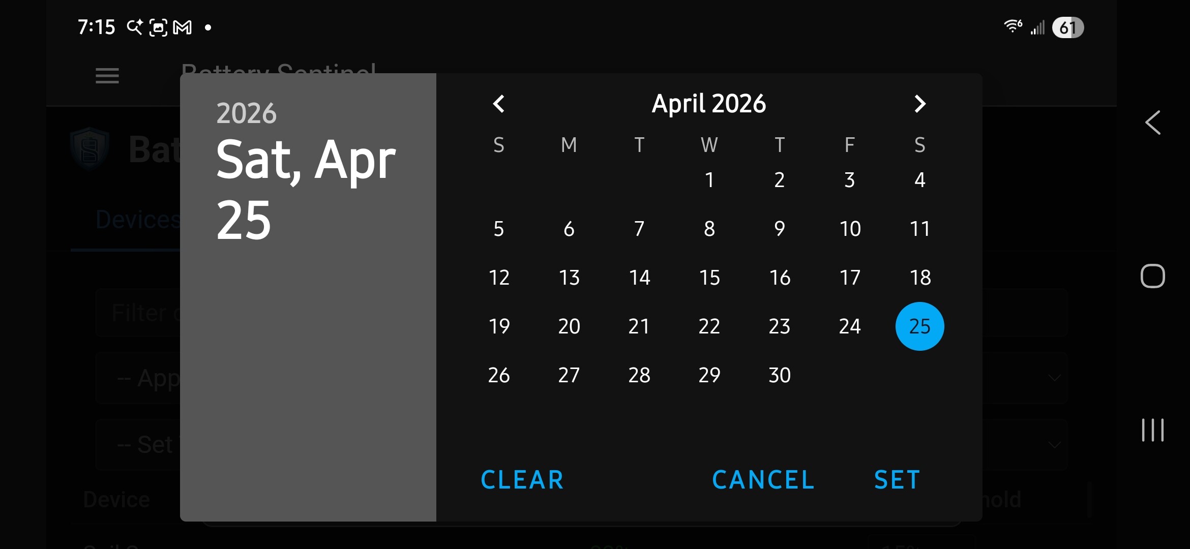

How are dashboard themes set? I’m getting black text on a black background in popups.
The date picker is a system-level popup rendered by Android, not Battery Sentinel - I have no control over its styling. It looks like maybe you have the HA app set to dark theme but your Android system theme is set to light. The OS date picker ignores the app theme and uses the system theme, which causes the conflict. Switching Android to dark mode (Settings > Display > Dark theme) should fix it. On my Android everything looks okay.
Also, for support questions and bug reports please use GitHub Issues rather than this thread so others can find and follow along and this thread doesn’t get filled with support issues. Thank you.

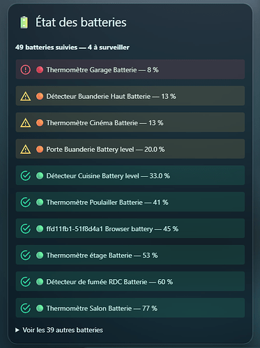

I created a card to put in dashboard :
type: markdown
title: 🔋 État des batteries
card_size: 8
content: >
  {% set exclude = ['sensor.maison_solar_optimizer_battery_soc',
  'sensor.iphone_de_margaux_battery_level', 'sensor.mobile_ln_battery_level_2',
  'sensor.cest_honteux_battery_level', 'sensor.hey2_w09_battery_level',
  'sensor.mobile_margaux_battery_level', 'sensor.mobile_leo_battery_level',
  'sensor.serrure_battery_level', 'sensor.pixel_9a_oliv_battery_level',
  'sensor.ipad_de_helene_battery_level',
  'sensor.browser_mod_d5e0d7d6_e001ecf2_browser_battery'] %}
  {% set all_states = (states.sensor | list) + (states.binary_sensor | list) %}
  {% set ns = namespace(items=[]) %}
  {% for e in all_states %}
  {% if e.attributes.get('device_class') == 'battery' and e.state not in
  ['unknown', 'unavailable'] and e.entity_id not in exclude %}
  {% if e.domain == 'binary_sensor' %}
  {% set lvl = 0 if e.state == 'on' else 100 %}
  {% set disp = 'Faible' if e.state == 'on' else 'OK' %}
  {% else %}
  {% set lvl = e.state | float(-1) %}
  {% set disp = e.state ~ ' %' %}
  {% endif %}
  {% if lvl >= 0 %}
  {% set ns.items = ns.items + [{'name': e.name, 'lvl': lvl, 'disp': disp}] %}
  {% endif %}
  {% endif %}
  {% endfor %}
  {% set sorted_items = ns.items | sort(attribute='lvl') %}
  {% set top = sorted_items[:10] %}
  {% set rest = sorted_items[10:] %}
  **{{ sorted_items | length }} batteries suivies — {{ sorted_items |
  selectattr('lvl', 'lt', 25) | list | length }} à surveiller**
  {% for item in top %}
  {% if item.lvl < 10 %}<ha-alert alert-type="error">🔴 {{ item.name }} — {{
  item.disp }}</ha-alert>
  {% elif item.lvl < 25 %}<ha-alert alert-type="warning">🟠 {{ item.name }} — {{
  {% else %}<ha-alert alert-type="success">🟢 {{ item.name }} — {{ item.disp
  }}</ha-alert>
  {% endif %}
  {% endfor %}
  {% if rest | length > 0 %}
  <details>
  <summary>Voir les {{ rest | length }} autres batteries</summary>
  {% for item in rest %}
  }}</ha-alert>
  {% endif %}
  {% endfor %}
  </details>
  {% endif %}
Have a nice day!
