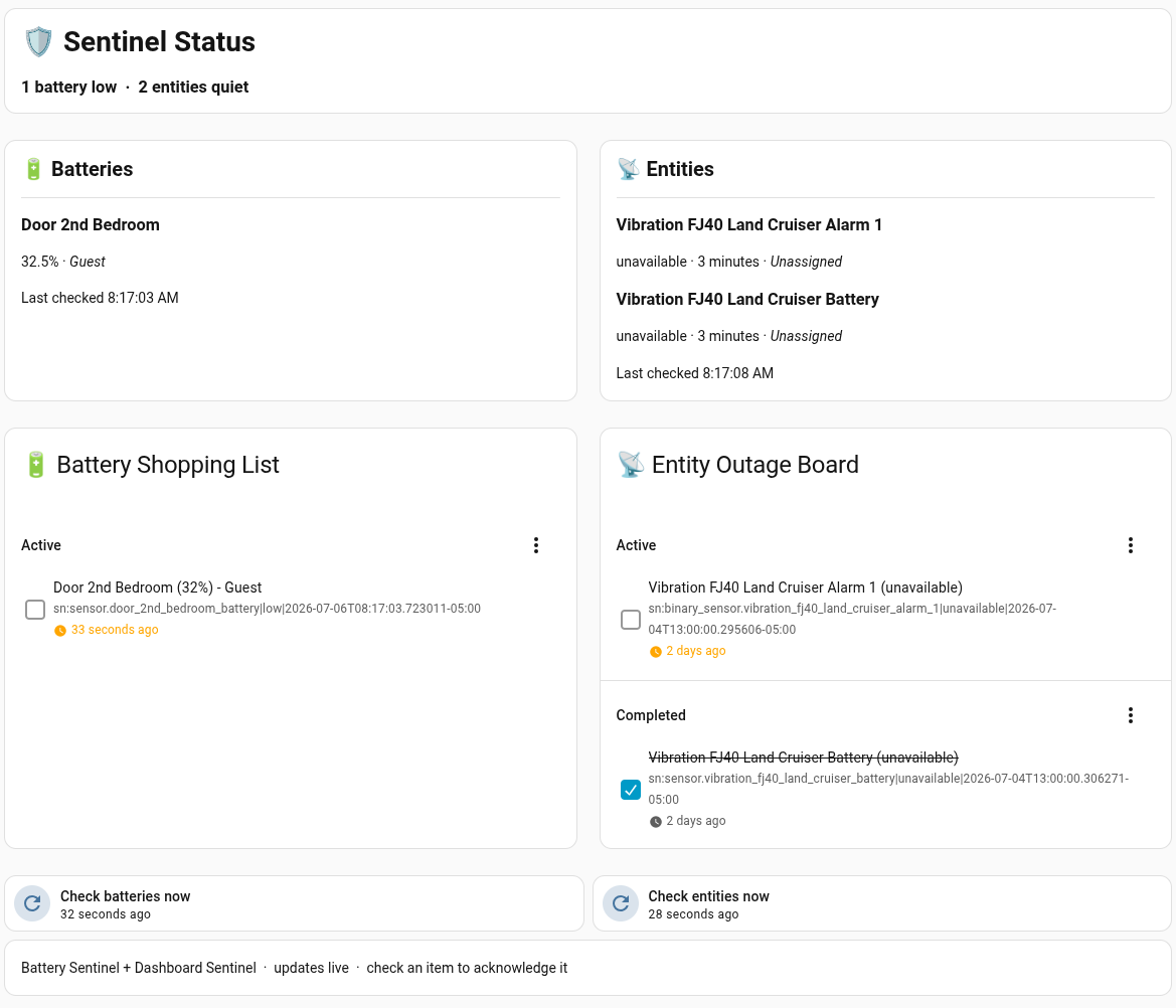

Here is the whole set in service, my dashboard this morning:
Entity Sentinel flagged the two truck sensors on the outage board, and I checked one off so it stops alerting until it recovers. Battery Sentinel put the one low battery on the shopping list with its percentage and area. Sentinel Notify maintains both lists and sent exactly two pushes for all of this, one per event, and nothing since. The status cards read straight from the two detectors, Entity Sentinel now merges its tiers into one list on its own, so they go green as things heal. Nothing in the picture is managed by hand.
