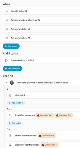

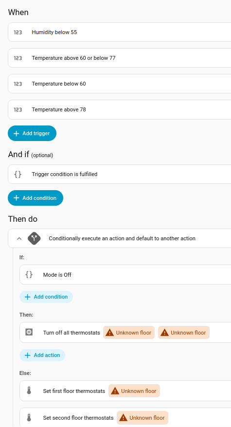

Here are your three automations consolidated into one.
Summary
alias: EnergySave Good Wx
description: ""
triggers:
  - alias: Humidity below 55
    trigger: numeric_state
    entity_id: weather.forecast_home
    attribute: humidity
    below: 55
    variables:
      is_true: "{{ 60 < states_attr('weather.home', 'temperature') < 77 }}"
      mode: "off"
  - alias: Temperature above 60 or below 77
    attribute: temperature
    above: 60
    below: 77
    variables:
      is_true: "{{ states_attr('weather.home', 'humidity') < 55 }}"
      mode: "off"
  - alias: Temperature below 60
    below: 60
    variables:
      is_true: "{{ true }}"
      mode: heat
  - alias: Temperature above 78
    above: 78
    variables:
      mode: cool
conditions:
  - alias: Trigger condition is fulfilled
    condition: template
    value_template: "{{ is_true }}"
actions:
  - if:
      - alias: Mode is Off
        condition: template
        value_template: "{{ mode == 'off' }}"
    then:
      - alias: Turn off all thermostats
        action: climate.set_hvac_mode
          floor_id:
            - first
            - second
          hvac_mode: "off"
    else:
      - alias: Set first floor thermostats
        action: climate.set_temperature
          floor_id: first
          temperature: "{{ iif(mode == 'heat', 65, 75) }}"
          hvac_mode: "{{ mode }}"
      - alias: Set second floor thermostats
          temperature: "{{ iif(mode == 'heat', 62, 77) }}"
          floor_id: second
mode: single
It is purely event-based. There's no "battling" because all control logic is contained within a single automation.
EDIT
Revised the automation. Added more alias statements to improve legibility.
Image shows "Unknown floor" only because my system does not have floors named first and second.
In a nutshell:
  • Four triggers monitor temperature/humidity thresholds
  • One decision: Turn off the thermostats or set their mode and temperature.
I like your is_true approach to this. Nicely done.

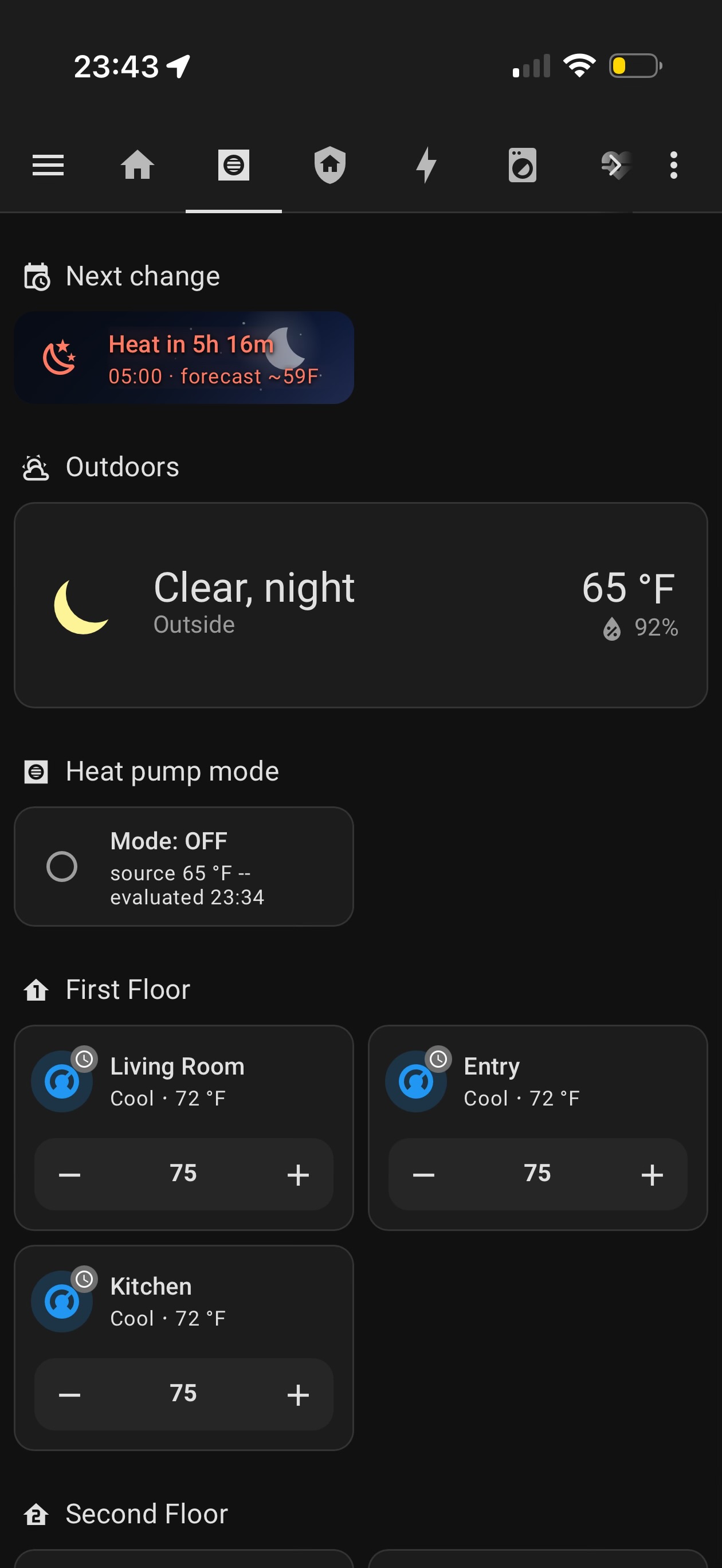

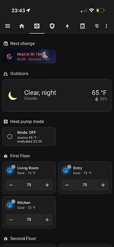

Any progress to report?
No dice on this, it despite OAT of 80 splits stayed off
state:
  translated: "Off"
  raw: "off"
  last_changed: "2026-06-28T19:08:08.704Z"
  last_updated: "2026-06-28T19:08:08.704Z"
attributes:
  icon: mdi:snowflake-thermometer
  friendly_name: HeatPumpSensor
alias: Heat Pumps
description: ""
triggers:
  - trigger: state
    entity_id:
      - sensor.heatpumpsensor
    to:
      - "off"
      - cool
      - heat
conditions: []
actions:
  - choose:
      - conditions:
          - condition: state
            entity_id: sensor.heatpumpsensor
            state:
              - "off"
        sequence:
          - action: climate.set_hvac_mode
              floor_id:
                - first
                - second
              hvac_mode: "off"
      - conditions:
          - condition: state
            state:
              - cool
        sequence:
          - action: climate.set_temperature
              floor_id: first
              temperature: 74
              hvac_mode: cool
              temperature: 73
              hvac_mode: cool
              floor_id: second
      - conditions:
          - condition: state
            state:
              - heat
        sequence:
              floor_id: first
              temperature: 65
              hvac_mode: heat
              temperature: 62
              hvac_mode: heat
              floor_id: second
mode: single
When I asked if you had made any progress, I had assumed you tested the automation I suggested. However, the one you reported is "no dice" is not mine but dtrott's. Hopefully he will be able to help you with it.
Probably need more info on what happens.
Specifically with respect to how the template sensor varies with actual temperature.
