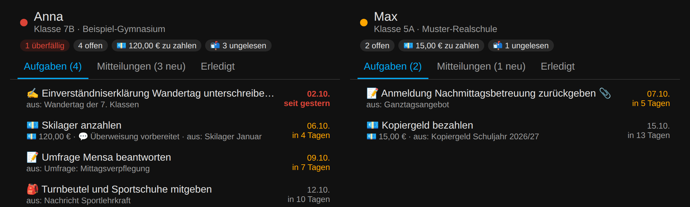

  • optionally lets an AI (AI Task, e.g. Anthropic, OpenAI, Google, Ollama) work out what you actually have to do: sign, pay (with amount, IBAN and payment reference), return, bring along – including the deadline

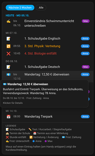

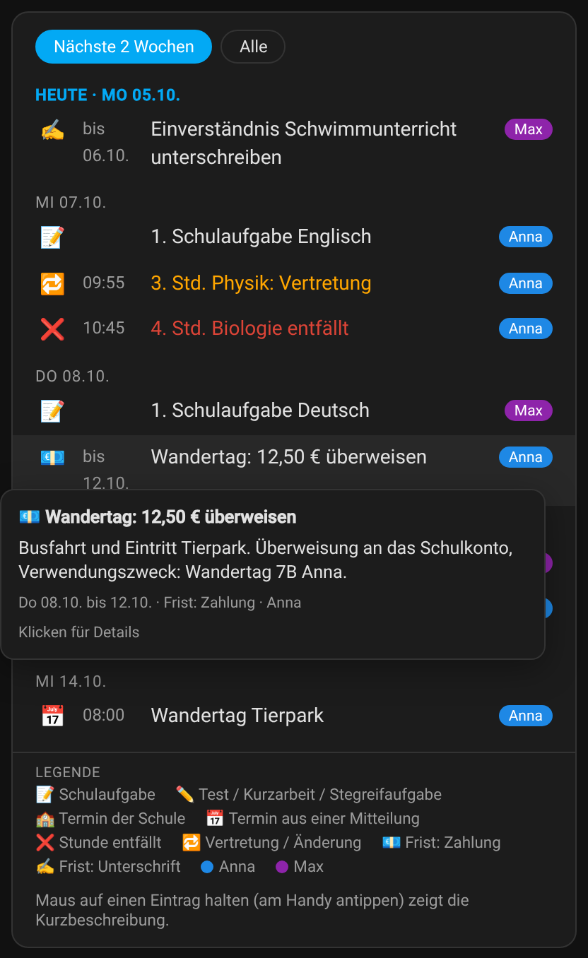

  • to-do list and calendar per child, traffic-light sensor, push reminders, a morning summary and voice announcements

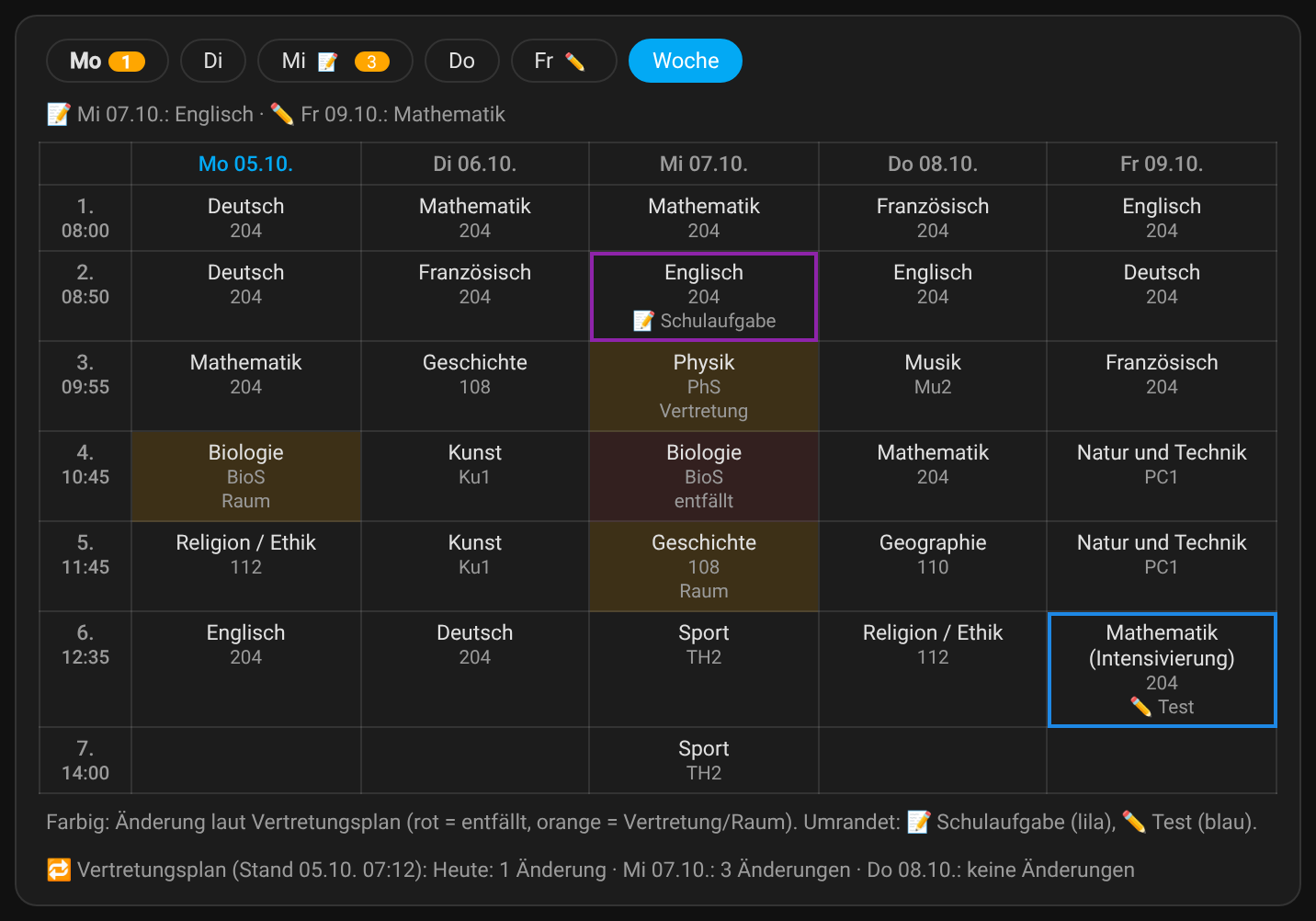

  • creates a ready-made “Schule” dashboard with its own cards
(All screenshots show made-up demo data.)
