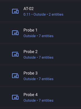

I just tested with my AT-02, I don’t seem to get an entitiy for the ambient temperature, Probe 0. There’s only ā€˜Alarm interval’ and ā€˜Battery’. But I’m not on dev channel, so this might have been fixed allready?
The 4 probes seem to be working ok.
I don’t have ambient temp in mine so have not figured out how to add it yet.

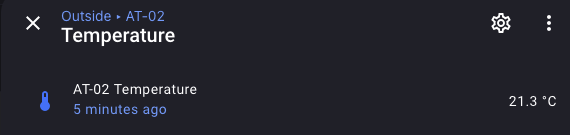

@elupus, I also have an AT-02. Running uv run togrill-bluetooth connect <device-addres> debug I can see my two external probes plus the ambient temperature. So this leads me to believe the library already has the functionality however in home assistant I can only see four probes and not the ambient.
How can I help to get the ambient sensor to show in home assistant?
togrill integration:
to-grill-bluetooth library:
Screenshot 2025-12-27 at 2.18.49 PM
@elupus I have created a PR (Add ambient temperature sensor to ToGrill by pandanz Ā· Pull Request #159798 Ā· home-assistant/core Ā· GitHub) which adds the ambient temperature sensor if the device supports it.
