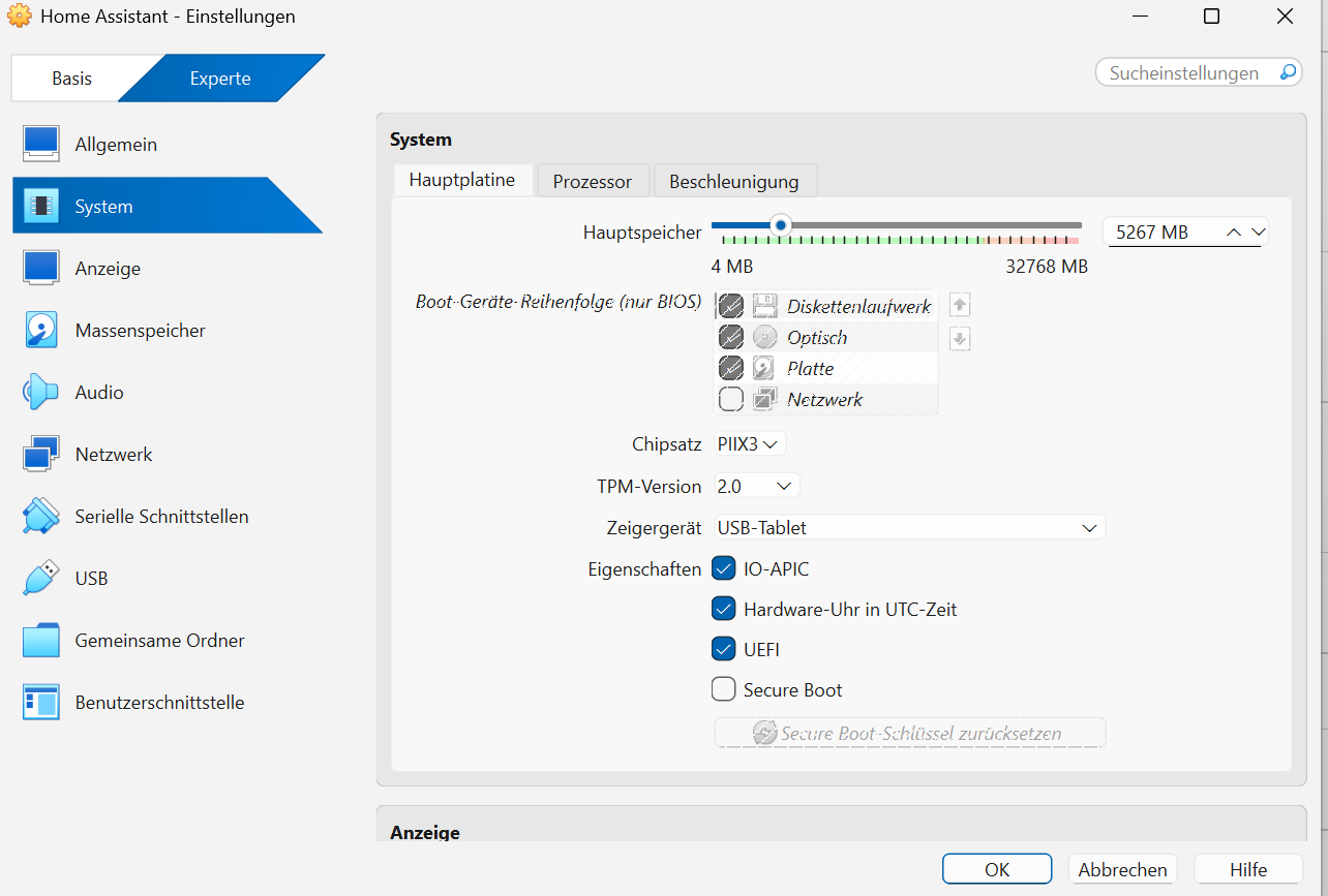

Why can’t he start the setup? It is set as in the manual. Does anyone have an idea?
UEFI is active
This does not look like a UEFI boot. Share your config.
The configuration corresponds to these instructions:
If I remove the check mark at UEFI, the only thing that comes up is: No Bootable medium found!
Massenspeicher: File: haos_ova-18.1.vdi
Make sure you imported the actual HAOS VDI. Should look something like this
See how the size is different?
Thanks, that was the mistake. Three times newly selected, but done wrong. The fault was in front of the device, as is so often the case. Thank you
