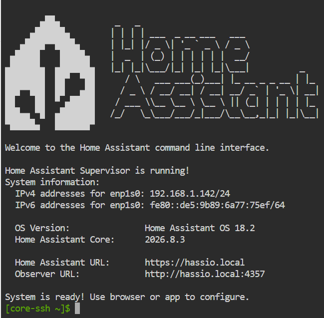

CLI:
Seeing this error in logs
Logger: homeassistant.components.network
Source: components/network/init.py:74
Integration: Network Configuration (documentation, issues)
First occurred: 6:04:19 PM (35 occurrences)
Last logged: 6:20:29 PM
Because the system does not have any enabled IPv4 addresses, source address detection may be inaccurate

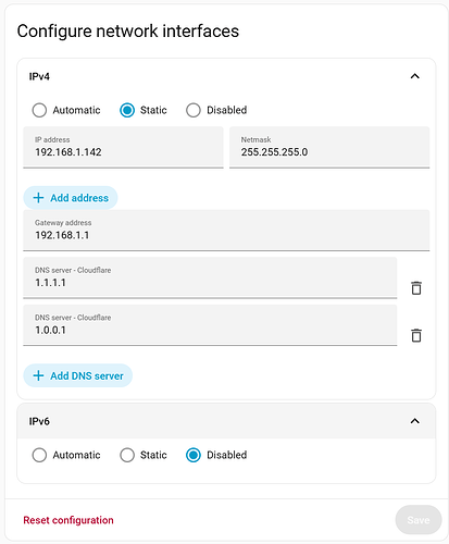

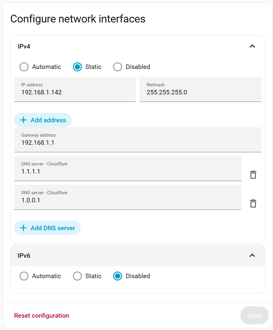

  1. Many integrations that rely on other local devices that need to access another local IP cannot seem to do so anymore (reolink, lutron..etc.) They cannot initiate.
  2. Cannot access HA locally via https://192.168.1.142:443. Yes, Port 443 is what the port is set to in settings.
  3. I have a reverse proxy set up and can ONLY access HA via the reverse proxy…not locally.
  4. Cannot log back into Home Assistant Cloud
It’s as if my Home Assistant cannot access anything on the network locally…
