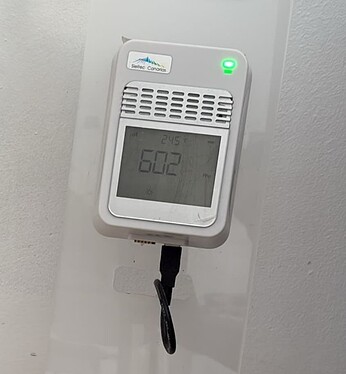

The apartment we rented for a holiday stay had one of these indoor sensors installed:
We were honestly not aware that CO₂ was a potential risk at this destination. The Airbnb host downplayed it (“think of it like a smoke detector, just a precaution”), but my partner was understandably uneasy. So I decided to turn it into a small holiday Home Assistant project. It turned out to be much easier than I expected.
