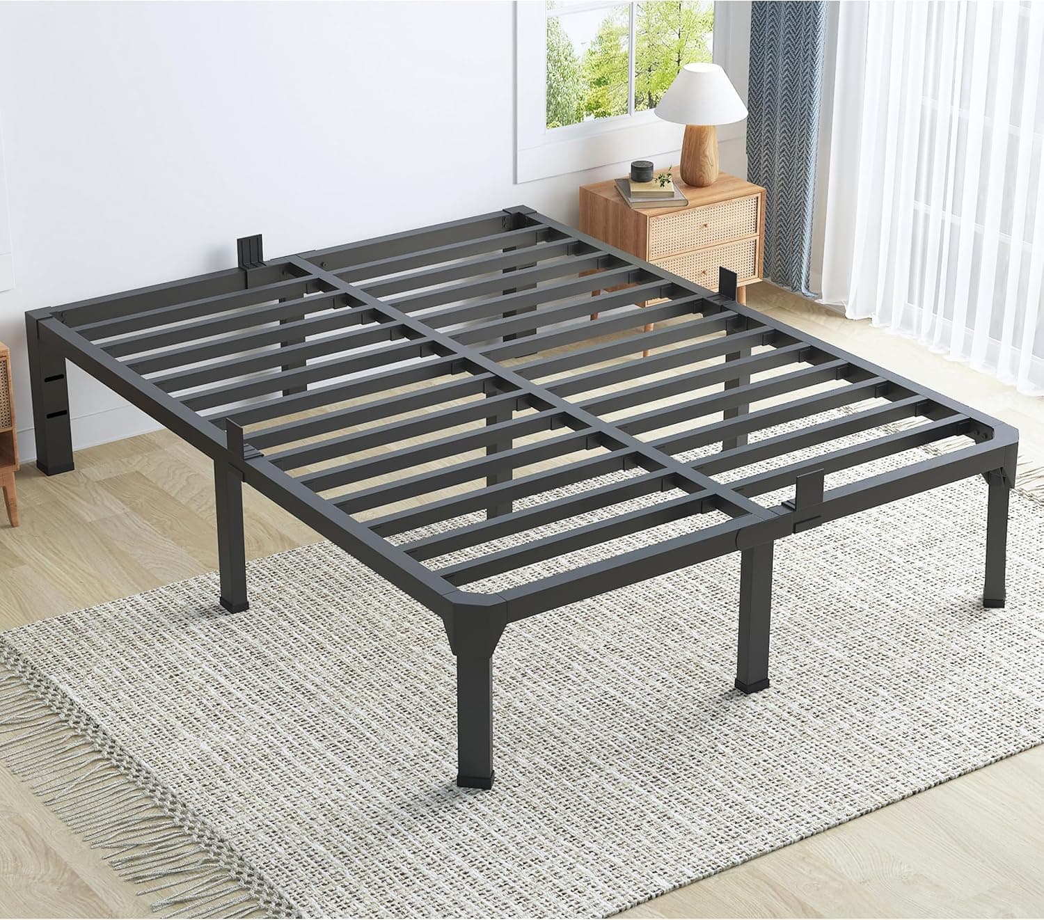

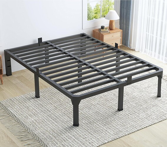

anyone have any thoughts on mounting this with a metal foundation bed like this.
i don’t think double sticky tape will hold it, so i may have to zip tie it under the slat and then bring the extension wires up to the sensor strip.
Figured i would ask here first :slight_smile:
Use the adhesive backing and back it up with: Bed Presence for ESPHome by Elevated Sensors - #248 by tom_l
