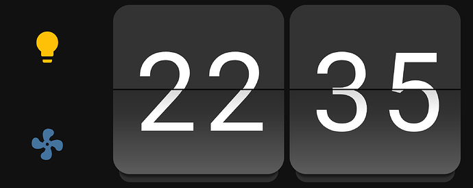

It took me many many hours this weekend and it took a long way to get there, but I basically did what @almighty59 suggested: a custom grid layout, with a few added features. Thank you @anon60850888 because I used the thread you linked to find the card I ended up using. This was a lot for me to learn in a weekend, but I’m going to type up a summary and then share what I ended up with for those who need help in the future
First off, I’m quite disappointed with how difficult this was for a newbie. All I wanted was a clock and two buttons. The built in clock is horribly uncustomizable, and we should be able to just drag and resize cards all on the same screen. Why can’t I just drag a card and have it stay in it’s place? This was extremely frustrating.
CLOCK
I went with the PQINA Flip Clock since it was easy and looked good. I already had HACS installed so I was able to download it and get it on a dashboard easily.
LAYOUT
This was the most challenging part overall. I wanted two smaller buttons stacked vertically to the left of the clock. Putting the buttons on the left was the hard part. I tried nesting the default vertical and horizontal stack cards, but I was unable to resize the columns how I wanted. I then looked at Layout-card, Ultra Card, then went back to Layout-card. The big issue I had was getting things to resize between my laptop and the phone. Lesson learned: if you want multiple rows and columns, do NOT try to use nested stacked cards. Go straight to a custom grid card. I also never got the ‘place-content’ option to function correctly in the grid.
OTHER FEATURES
I wanted a cleaner design so I also grabbed the Custom Button Card, Kiosk-mode, and Card Mod. Each of these takes time to figure out, especially when you don’t know any CSS. Kiosk mode sounded great until I thought I locked myself out of editing the dashboard. I then needed to figure out how to automate showing and hiding the header.

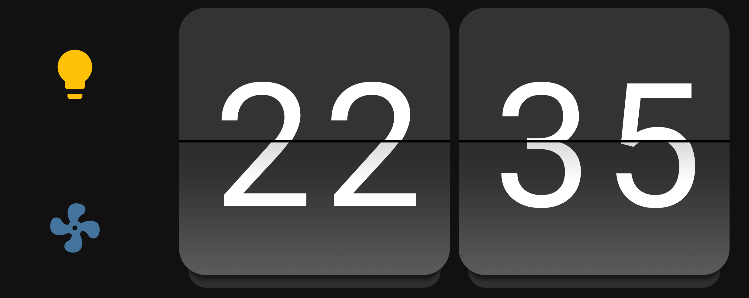

This is what I ended with:
It resizes to my phone well, but I still have some tweaks to make. I could not figure out why there’s a larger gap between the cards than everywhere else. Overall this looks so simple and youtubers make it look easy, but wow is it a steep learning curve when you’re still new to HA and also don’t know things like CSS grid formats.

I never said it would be easy. Lol. However, it looks like you figured it out and in my opinion it looks good.
FYI: You might be able to avoid using panel' as the view type and instead just use custom:grid-layout`.
