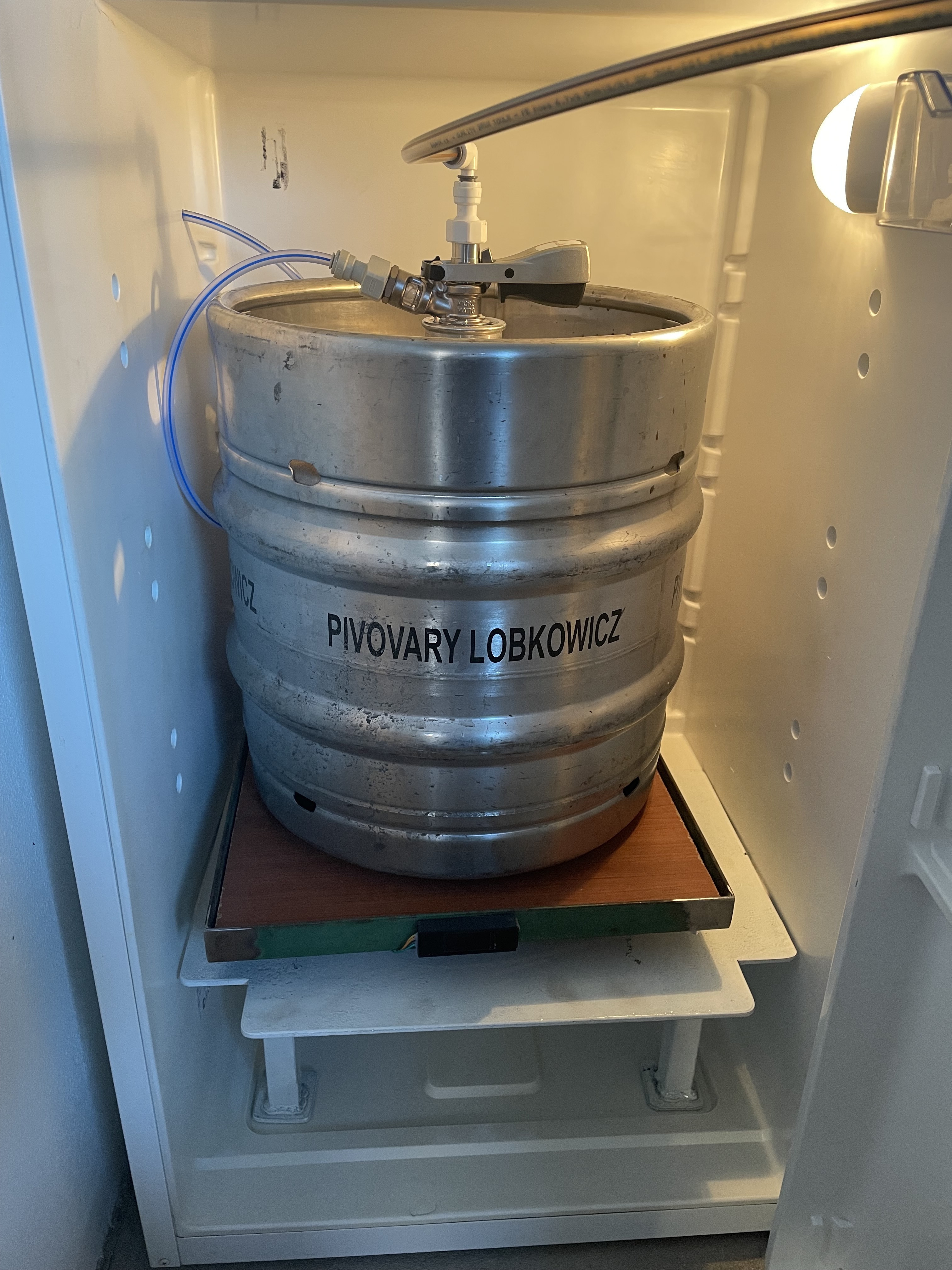

A DIY scale that sits under your keg in the fridge and tells you exactly how much beer is left – in kg and number of remaining half-pints.

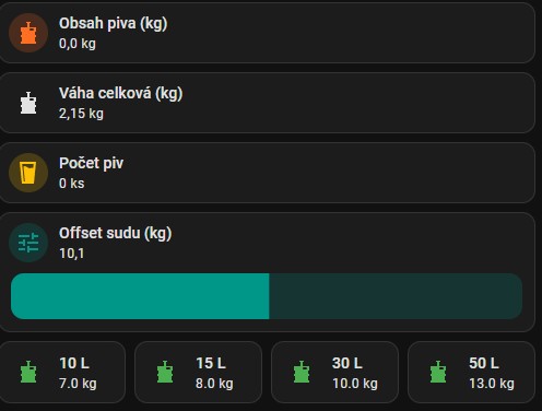

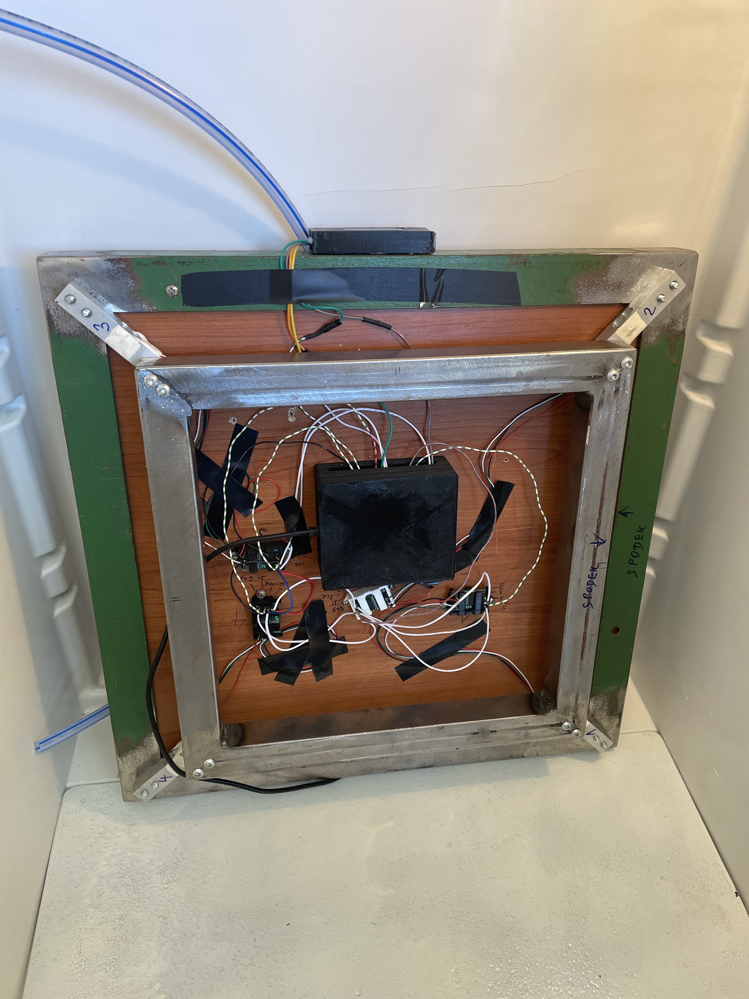

  • 4× load cells (HX711 24-bit ADC) with median + EMA filtering for stable readings
  • OLED display (SH1106 128×64) showing beer content in kg and beer count in real time
  • Two-step calibration (A: store zero / B: calculate scale) with persistent flash storage – survives restarts
  • Full Home Assistant integration via ESPHome API – sensors, controls, automations

:wrench: Hardware
Component Spec Qty
ESP32 DevKit v1 38-pin
HX711 24-bit ADC
Load cell 20 kg bar type
OLED SH1106 128×64 I2C
Total cost: ~$30 USD
:house: Home Assistant Dashboard
The included HA-Dashboard.yaml uses Mushroom cards and shows beer content, beer count, keg offset slider, and quick-set buttons for common keg sizes.

NICE!!! DO YOU HAVE THIS AT HOME? :smiley:
Thank you, yes, I do
