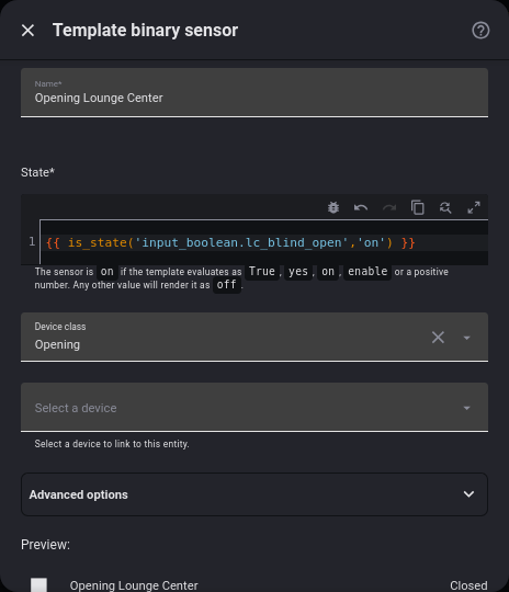

Just to add to the previous post… you are no longer limited to doing this in YAML since Template Binary Sensors can be created through the Helpers menu as well:
ah brilliant thank you very much all working now :slight_smile:
