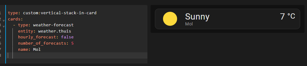

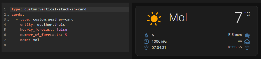

Still got the same card?
Try with the standard type: weather-forecast card.
  1. try without the stack in card
  2. check you weather integration settings

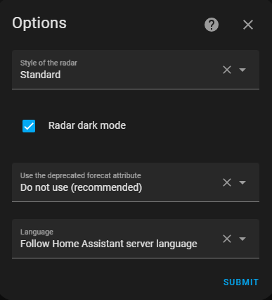

Open your Home Assistant instance and show your integrations.
There are settings in the integration → configuration about the type of forecast you want.
Still no change. I got the KMI one.

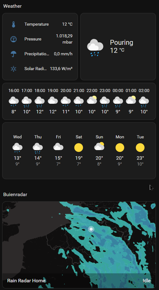

Awesome integration, exactly what I was hoping to find and more!
Integrated nicely on my dashboard, with own weather station information. (Also added the kmi link to it, so that if I click on it, I go straight to the KMI site for more detail.)

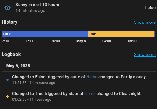

The first result did come out correctly as false. Will need to monitor it a couple days, but I suspect this does work exactly as advertised. Thanks a lot for the assistance.
Note to self: Maybe I need to start using ChatGPT every now and then :laughing:
Status update: The sensor is working pretty well and capturing the changing status pretty nicely :

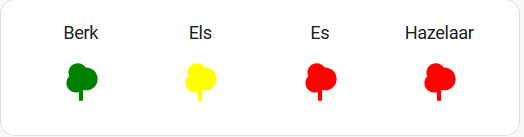

Just wanted to share my take on a pollen widget. It has large symbols in the color given by the API (if it has any) and hides them if they’re not active. The whole widget hides if no pollen are active. Right now I only included the tree pollen in it, as those are the only ones that matter for me, but you can easily adde the grass pollen as well. It uses the card-mod plugin.
type: entity-filter
conditions:
  - condition: state
    state_not: none
card:
  type: glance
  show_name: true
  show_icon: true
  show_state: false
  card_mod:
    style: |
      ha-card {
        --mdc-icon-size: 40px;
entities:
  - entity: sensor.home_birch_level
    card_mod:
      style: |
        :host {
          --card-mod-icon-color: {{ states(config.entity) }}
  - entity: sensor.home_alder_level
    card_mod:
      style: |
        :host {
  - entity: sensor.home_oak_level
  - entity: sensor.home_ash_level
  - entity: sensor.home_hazel_level
visibility:
  - condition: or
    conditions:
      - condition: state
        state_not: none
      - condition: state
        state_not: none
      - condition: state
        state_not: none
      - condition: state
        state_not: none
      - condition: state
        state_not: none

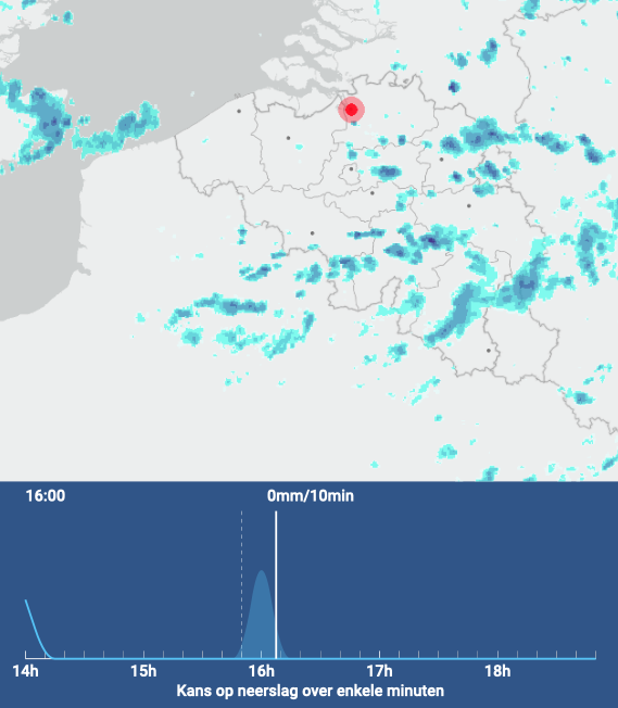

Hi @jdejaegh, I love your integration… it really works!
Question though: in my wall mounted iPhone I would like to have a card that just shows the text below the radar (in this case just show “Kans op neerslag over enkele minuten”) and when I click it, it should show the full radar.
Is it possible to have that text as a sensor or so? I can’t seem to find that… just to extract that text.
Thanks!
Edit: found it… state_attr('camera.radar_home', 'hint')
