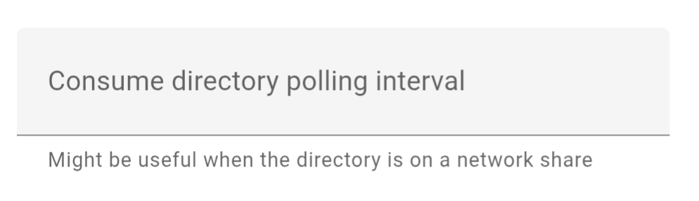

When I copy the files into the consume folder nothing happens. I already know that I have to add
ā€œ#PAPERLESS_CONSUMER_POLLING=10ā€ into the paperless.config. Where I can find this file?
In addon_configs/cc0815_g17_paperless-ngx I only able to find paperless.config.example and when I add the row above this not work.
Does anyone know where I can find the correct file?
You need to do that from the add-on setting tab inside HA Gui
