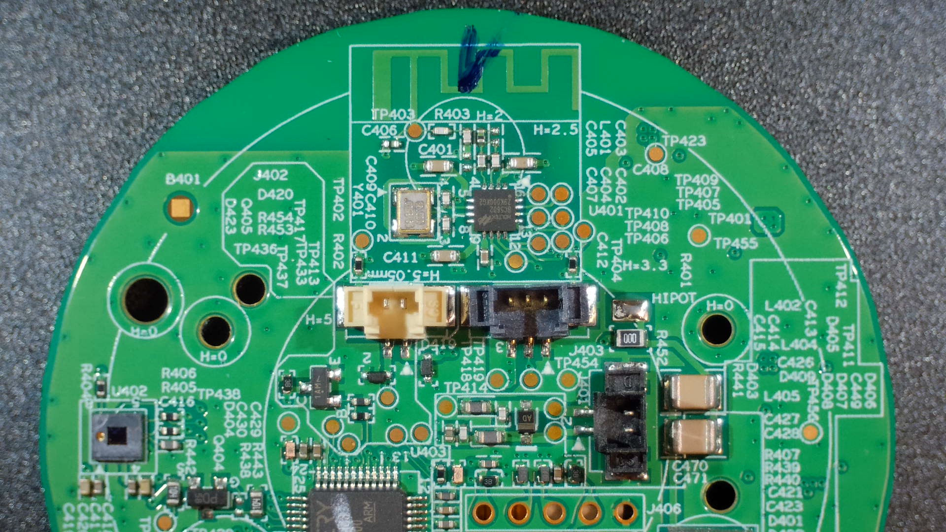

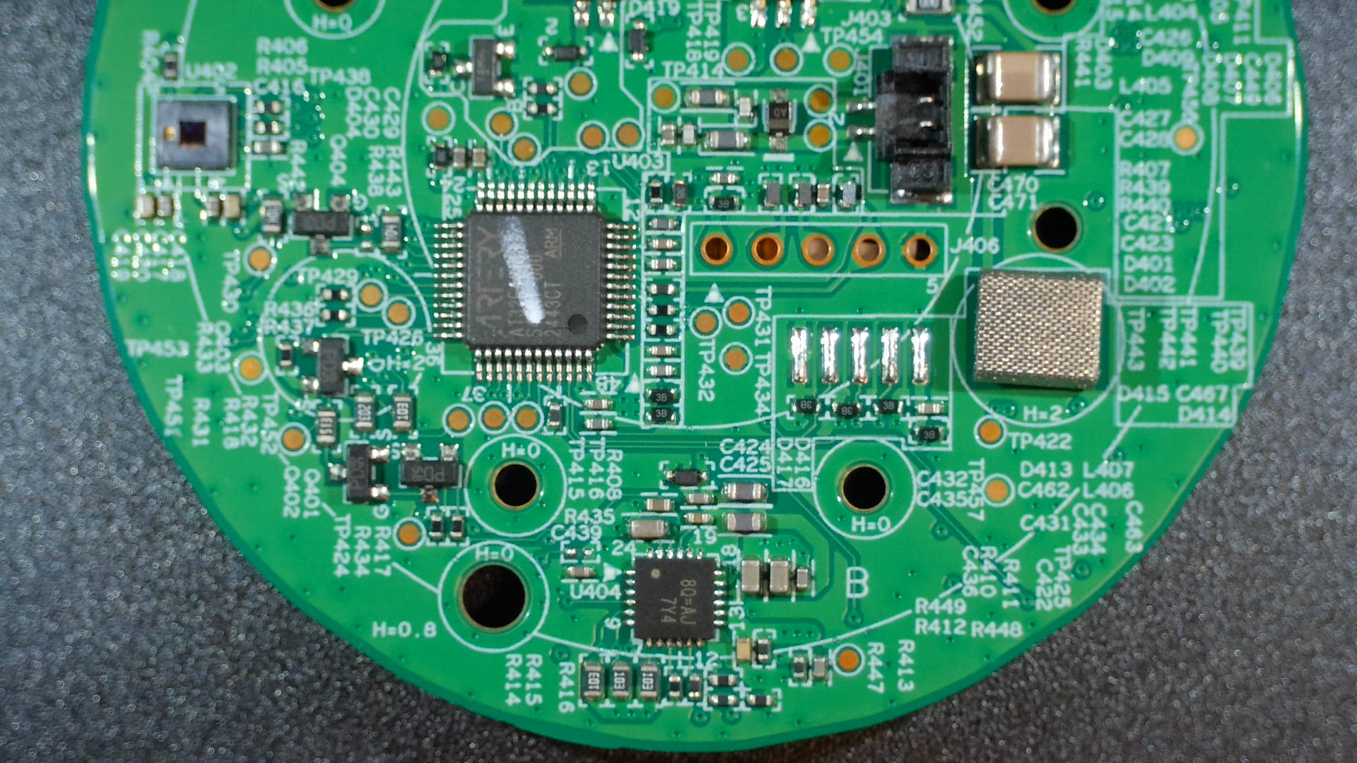

My ScreenBar arrived and I opened up the puck to see what we have to work with.

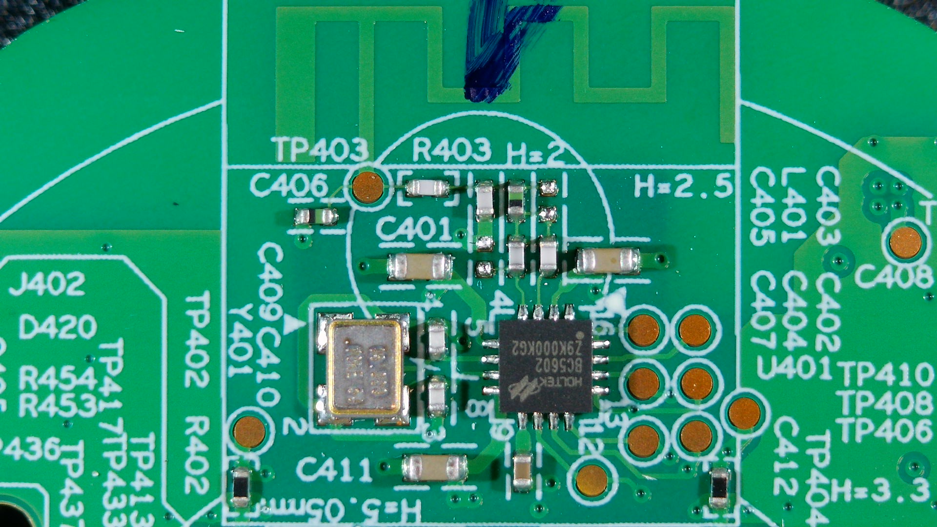

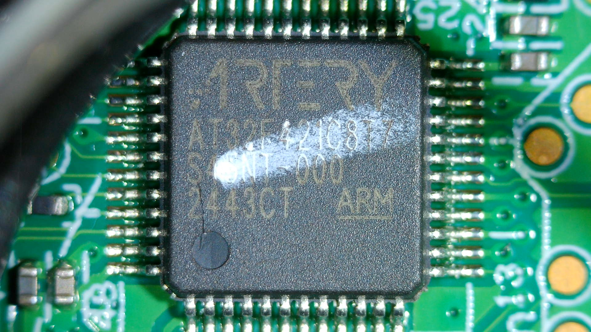

The highlights are the radio and MCU:

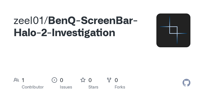

For more images and details I put everything here:
Sorry some of the images are in two parts, my microscope can’t zoom out any further than this.
