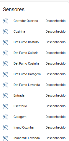

Can you help me and tell me why the sensors are all like this, “Unknown”.
The integration discovered the sensors, but it does not show their status, whether or not it detects movement. Or is the integration not ready for this yet? Does it only work when the alarm is activated?
