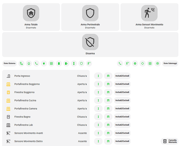

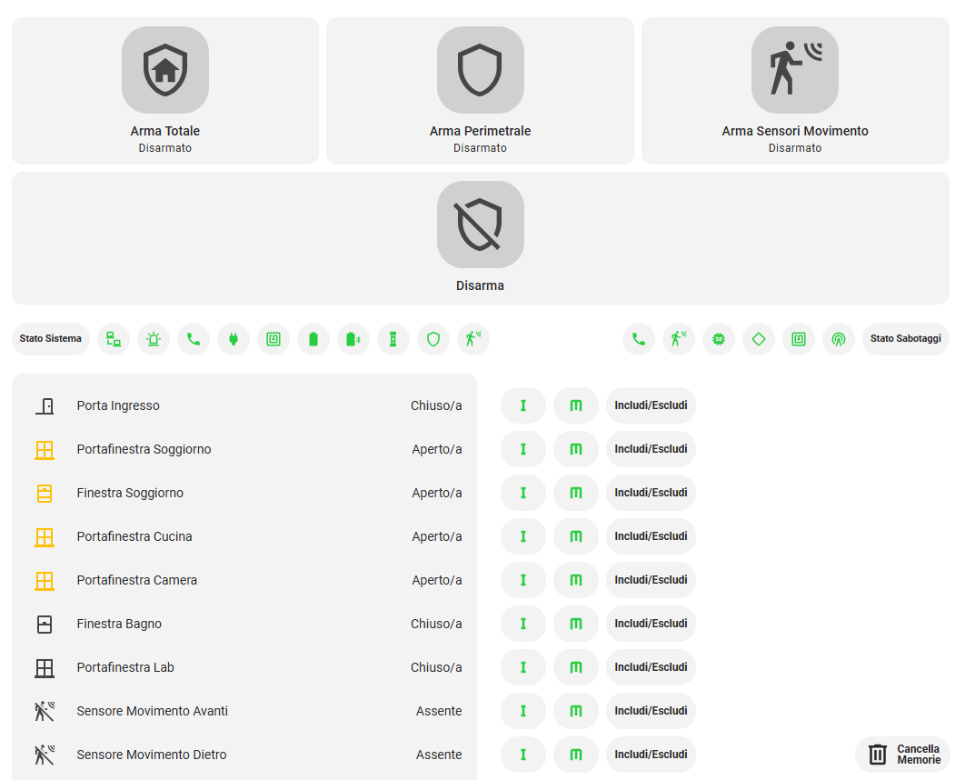

In the meantime, I created my first alarm card!

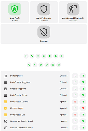

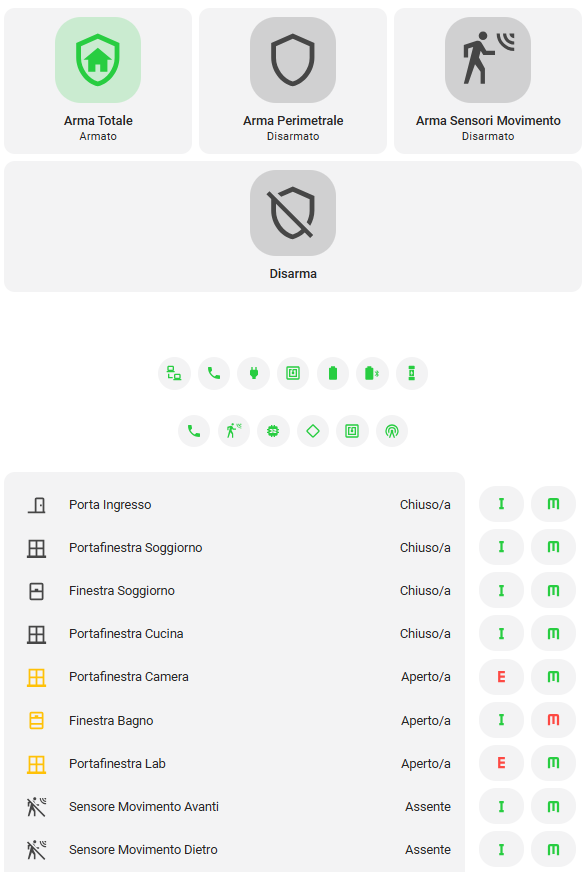

I can arm the whole system or the two areas independently. I can see the full system status, including tampering, using the chips card.
I can also see the status of every zone — whether it’s included or excluded — and whether there are any memory alarms.
It would be great to have a popup asking for a PIN when pressing the disarm button, before actually disarming the system. Any suggestions on how to implement that?
It’s still a work in progress!

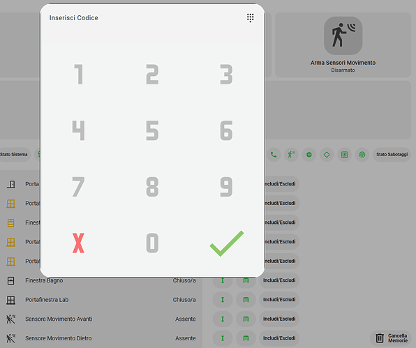

Done… i’m happy with my kyo32 card with code to disarm the alarm, maybe not the safest solution but at least is something…
pressing the disarm button opens a popup (browser mod) with a pin pad

To create a panel with a code entry keypad, I followed a guide I found online and adapted it to my needs.
I also tried to create a file to share/distribute it, but I wasn’t able to.
Here are the steps I followed to create the keypad:
1. Create a script with the following YAML:

            - type: custom:button-card
              show_name: false
              show_icon: true
              aspect_ratio: 1/.75
              tap_action:
                action: perform-action
                perform_action: input_boolean.turn_on
                  entity_id: input_boolean.verifica_codice
              icon: mdi:check
              styles:
                card:
                  - background: none
                  - border: none
                  - "--mdc-ripple-press-opacity": 0
                icon:
                  - color: "#8dc869"
If anyone wants to create a package or a blueprint with everything needed, feel absolutely free to do so :slight_smile:
