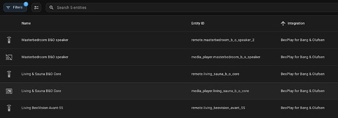

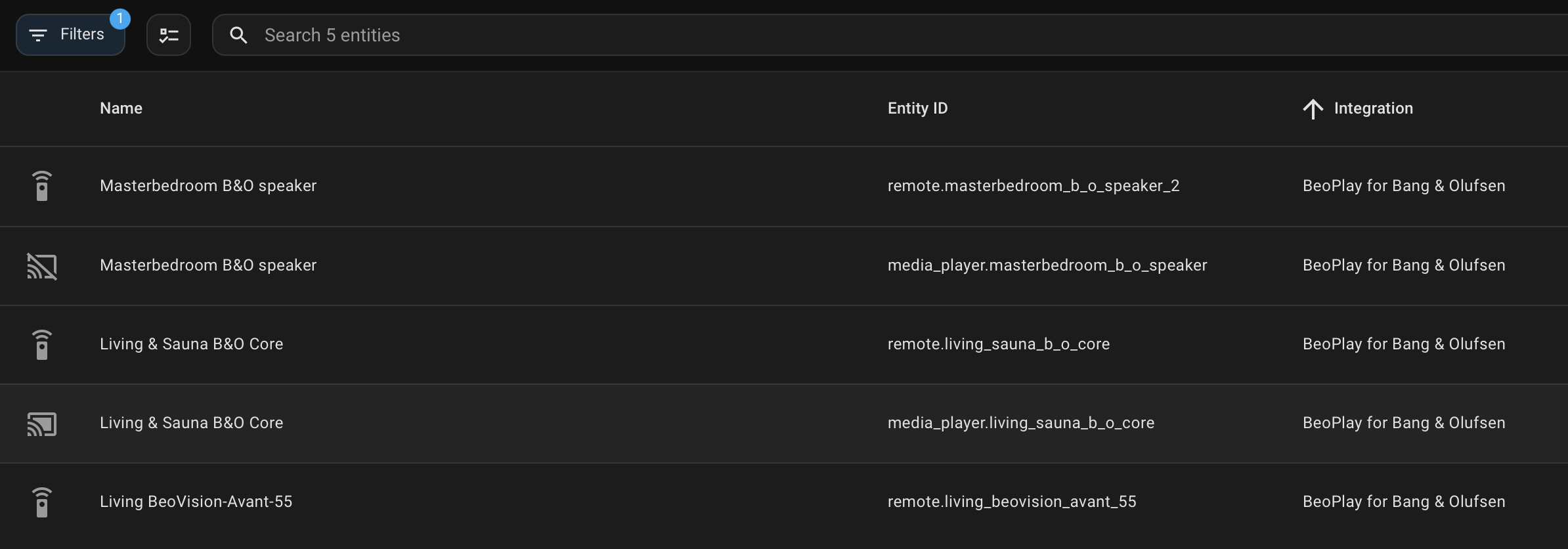

After the latest update (or one of the prior versions as I’m not constantly updating the integration), the media_player entity for the Avant has disappeared.
Currently there is only the remote entity for the Avant. Is this on purpose or was something forgotten?
In this screenshot you can see for each B&O entity a media_player entity has been defined automatically. For the Avant there isn’t. That’s really a pity as for simple things like volume I cannot integrate and control in HA anymore… Also the media_player is not automatically seen in Music Assistant to be added.
In one of my screenshots above in this topic, you can see in a prior version both entities were there.
I have deleted the configuration for the Avant and added it again, while restarting intermediately but nothing happens. I did it twice but when adding only the remote is visible.
You should probably report is as an issue on the repo: GitHub - giachello/beoplay: Home Assistant component to control BeoPlay including TVs, Speakers and others.
@jnathalia check if 2025.2.1 fixes it.
This has solved the issue! Many thanks @g.iac !
