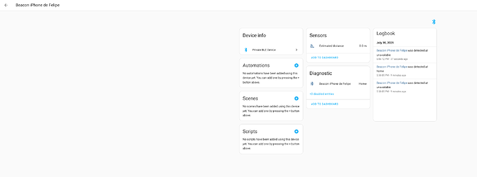

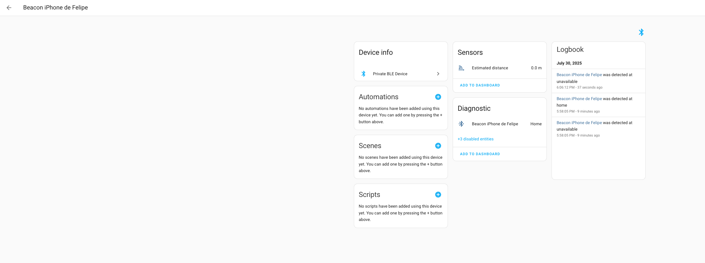

Hi! I’m trying to setup Bermuda to track my phone around my apartment, but after adding the Private BLE Device integration and adding my IRK, Bermuda doesn’t seem to recognize the device and add it’s tracker. Am I doing something wrong here?
You’re on the right track, so not sure why it’s not showing up. You could try restarting HA, or reloading the Bermuda integration. In “Device Info” it should show both “Private BLE Device” and “Bermuda”.
Which version of Bermuda do you have installed? Did you installl it via HACS, or manually?
Oh… one possibility is that you might have “installed” Bermuda (via HACS) but perhaps not “added the integration”, perhaps? does Bermuda show up in the previous screen, on the list of active integrations?

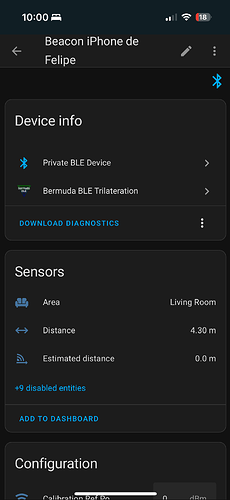

Reloading Bermuda did it :sweat_smile:
I had added the integration already, it was only a matter of reloading :man_facepalming:t2:
Thank you! Works now haha

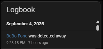

Id like to ask if theres something im missing in the ios setup…
Seems i have the frequent issue where an ios device will stop broadcasting when the screen goes off… I see a similar issue reported on github #579, but it was closed.
Are there any configurations ive missed in regards to the iphone 12 ios v15?
my Android v12 seems to work work fine.
Im a brand new Bermuda user and have installed the latest in regards to HA/EspHome/Bermuda
Are you using the private BLE integration to monitor your phone?
Yes, i used the ESP32 peripheral application to acquire the IRK and add it to the Private BLE Devices integration.
Now I’ve noticed that the user went to sleep with their phone, it doesn’t chime in at all :frowning:
fwiw, Both the working android, and this non working ios device have the companion app installed. Hope i didnt leave out any other relevant info
