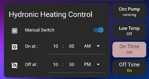

For example, below is the yaml for 2 button cards where the theme is set based on the state of an input helper.

      theme: "${hponstate === 'on' ? 'qSlate' : 'textcolorchange'}"

      theme: "${hpoffstate === 'on' ? 'qSlate' : 'textcolorchange'}"
