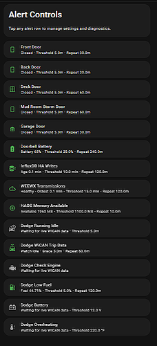

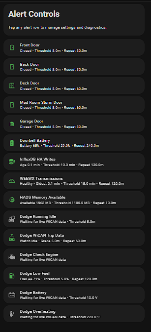

You should have a dashboard to control all of your alert parameters so you don’t have to tweak everything in code (hard coded) - and also so that you can put some of your alerts into a test mode -
Here is my alert control dashboard (a little ugly) -

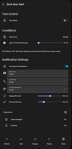

It has a browser-mod popup for each one, for instance you click on the alert for the back door being open and this little control panel comes up:
