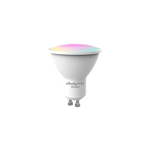

I prefer Shelly but they cannot deliver at the moment and I don’t know why
Maybe send them a message on the website.
