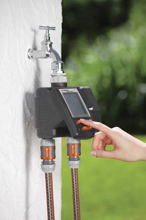

I think Tes8080 is looking for something like on the picture below, but for 4 zones:
To be honest I’ve not seen such device. But alternative solution is sort of splitter (from lack of better name) that takes one source and has 4 outputs, automatically switching between outputs every time it receives water flow from source. So from system control perspective it is seen as single valve, but to water 4 zones it must be switched on 4 times, each cycle serving different zone. I think Gardena was manufacturing such device some time ago.
