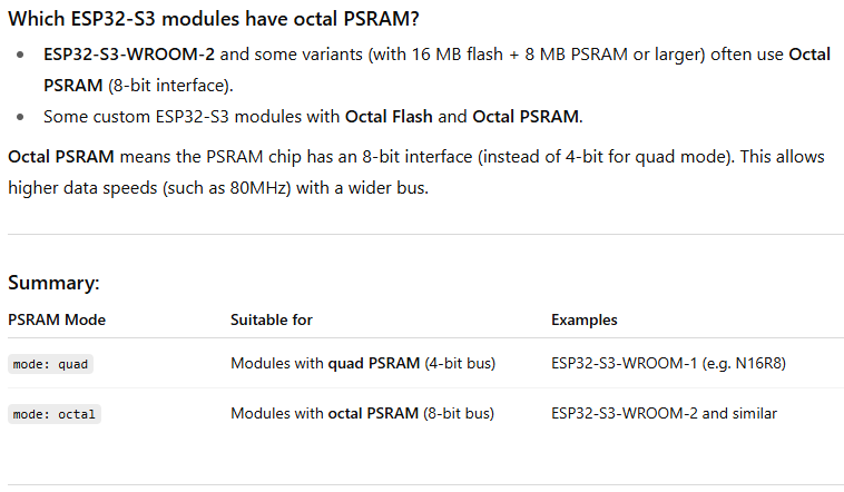

I bought a ESP32-S3 N16R8 (HARDWARE: ESP32S3 240MHz, 320KB RAM, 8MB Flash).
I changed the psram-code to ‘mode: quad’. That solved the problem for now, but I don’t know mode = quad is uselly for a N16R8…
For the n16r8 it should be set to octal

I checked chatGPT again. Is this true, because @lijiazhiren, I saw you used a esp32s3r16n8…

If ‘quad mode’ works correctly, there’s a high probability that the hardware’s PSRAM is faulty. Then, use ‘quad mode’. This setting will reduce performance slightly, but the impact isn’t significant.
