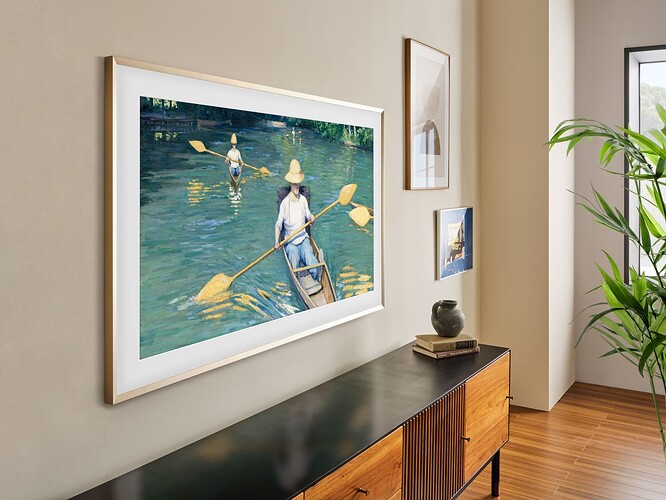

For a finishing touch you could build a shadow box around your tv when down to make it look more clean like this:

Arghhhh!!! They go to all the work of making the LCD TV’s without any frames and you want to put a frame around it?
There’s literally a line of tv from Samsung who market on this concept, its literally called “The Frame” and there’s tons of 3rd party picture frames for this tv.
that big picture is a tv in a picture frame :slight_smile:
https://www.bestbuy.com/product/samsung-32-class-the-frame-qled-full-hd-smart-tizen-tv-2023/J3ZYG2S3SV/sku/6537890
Since the time of this post, this project of mine is being revised tremendously, the tv will now be inside the wall the frame you see i dont want, rather a flush fit with picture frame around it
