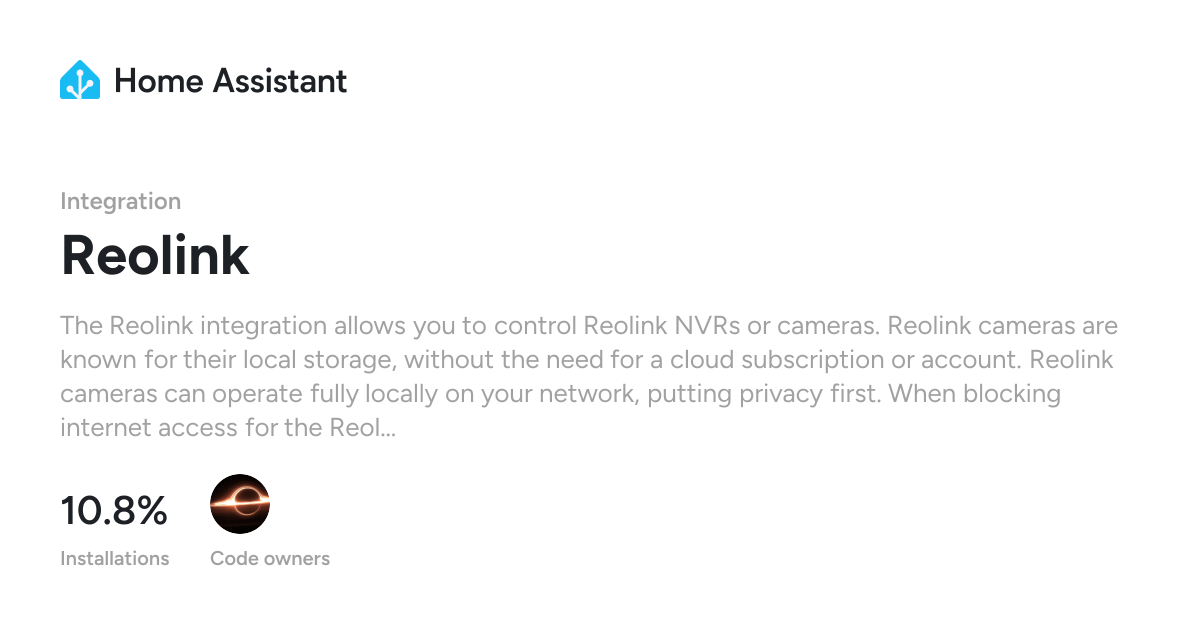

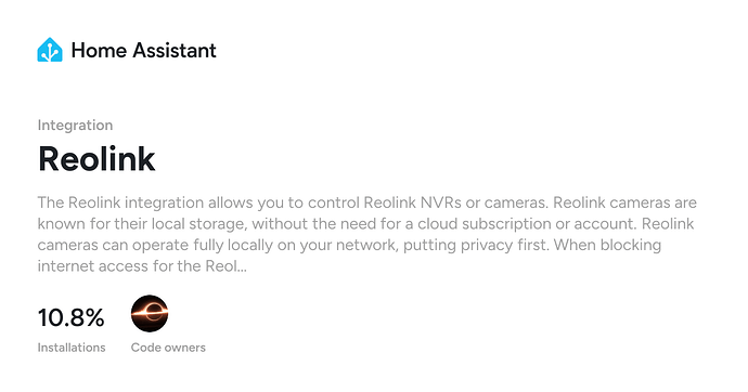

Reolink cameras can operate fully locally on your network, putting privacy first.
Reolink’s Home Hub localizes all your cameras.

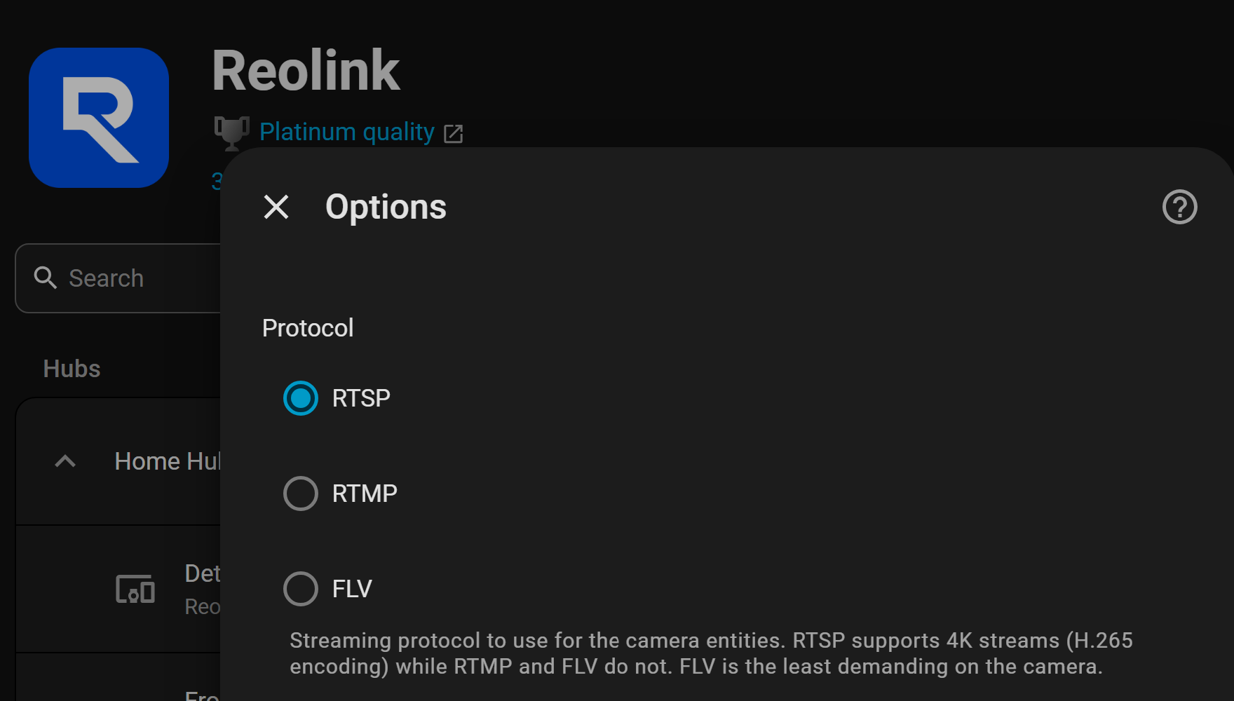

Yes you can control the protocols via the cameras or the HA intergration
