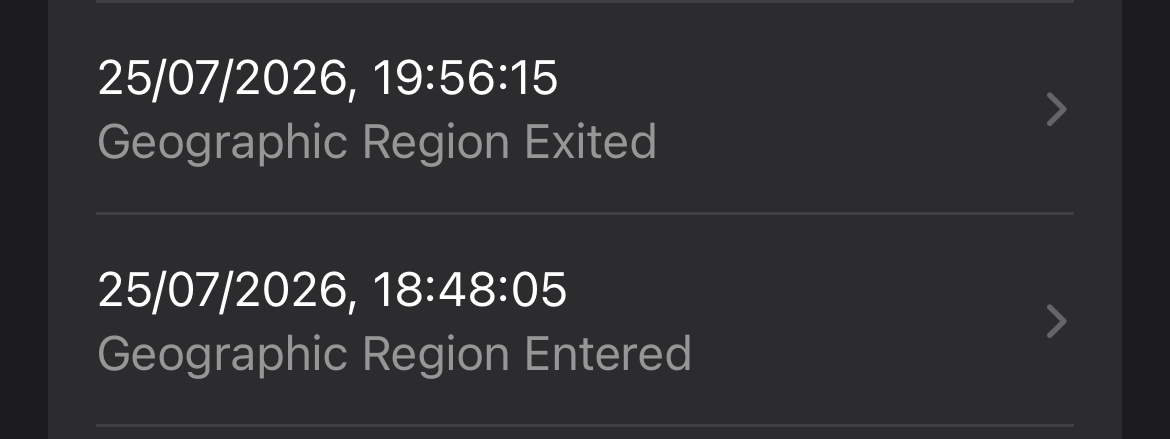

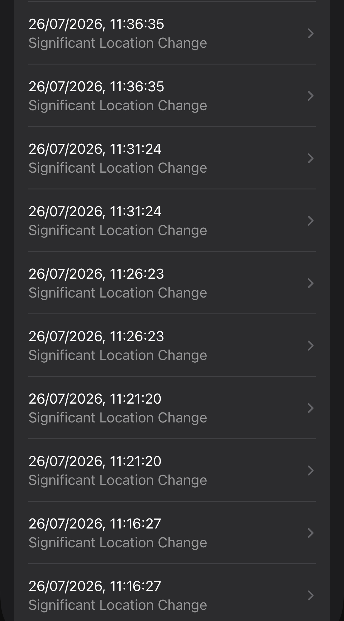

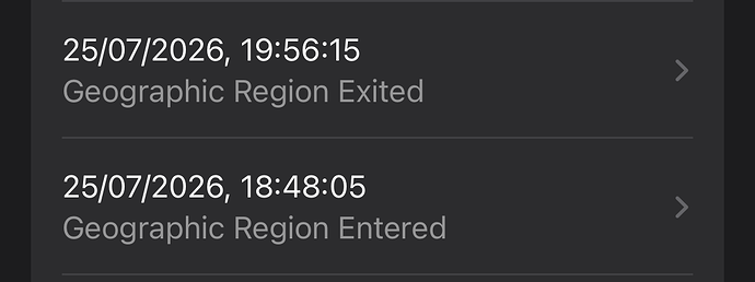

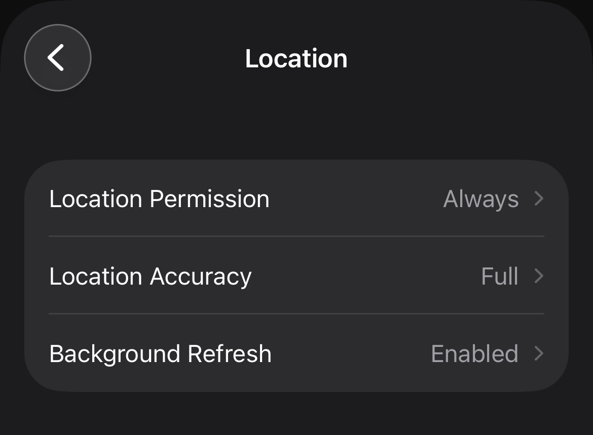

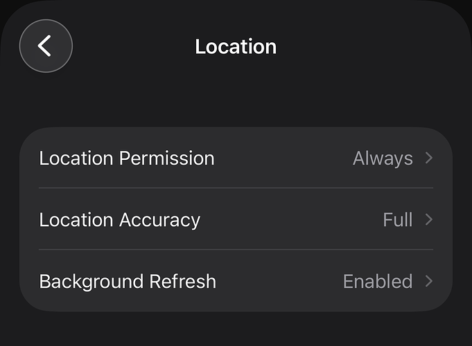

IOS.
Works pretty ok here (Netherlands)
Have to male sure HA app is on always allow (and check regularly):thinking:
Looks like it is updated at least every 5 minutes.
But it will also force updates when entering/leaving a geologic location (home, work, school etc)
