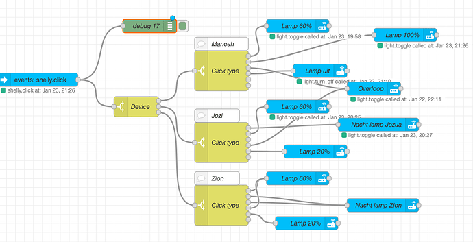

To make my question a bit more concrete, I want to share an example: My children each have their own button next to their bed to turn on their nightlight and the central bedroom lamp. Additionally, they can also turn on the hallway light. How would you translate something like this into an automation or script?
  • Should I set each button as a separate automation?
  • Can I migrate to one automation with multiple conditions
  • Or is it better to combine automations with scripts?
I have included a screenshot of Node-RED below for clarification.
I look forward to hearing your experiences and advice!

You could use trigger variables.
So each event is a separate trigger in the automation, and accompanied there are variables with the % and entity name.
The action could probably be just a light turn on with the variables being the entity and percentage.
I would not use scripts for this. This is far to simple, adding scripts will just make it more complex and harder to follow

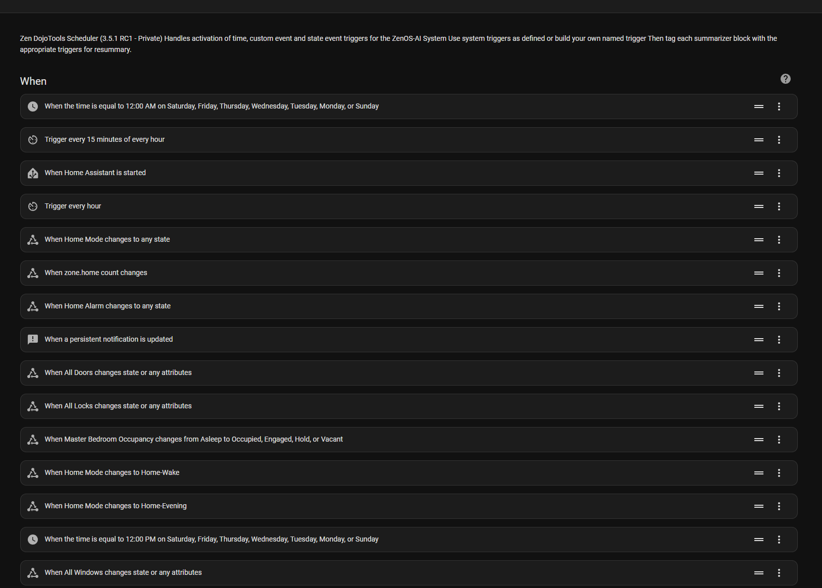

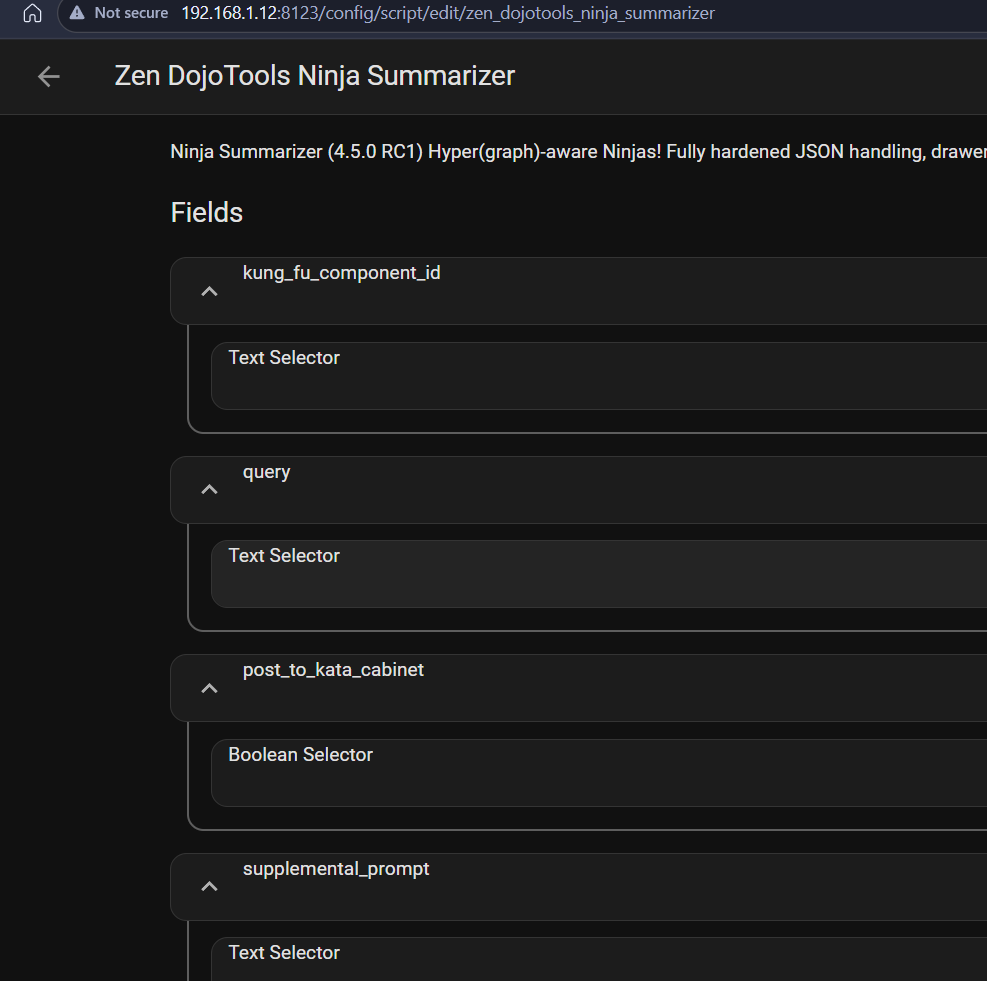

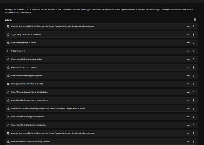

Always the first question -
First, Do I NEED an automation or script. (In most cases probably not or there’s another construct that already does the thing. Let’s assume I do.)
If I do, I then ask myself, what’s the simplest way to do it using HA built-in constructs. (For instance, if I’m trying to glue together a synthetic media console I use a Universal Media Player - not just a bunch of scripts because the endgame presents a media player so the rest of the system (and my LLM) can use it.
Then when I need to build automations / scripts, remember automations are just scripts with a trigger. Scripts can accept variables while automations on the other hand (yes, I’m ignoring the entire trigger variables discussion for now). Therefore, in my setup Automations are mostly just triggers ‘we need to do a thing now’. I then build a script accepting vars to ‘do the thing’ when necessary and then use automations to trigger those scripts.
For instance, scripts:
accept variables (fields)
Get called by automations:
Which marshal the when and why…
^^^ All those codepaths are just different cases for when triggers fire.
Yes, this is the most EXTREME version but that’s how I use it.
  • Script by default
  • Automation if I need a trigger
  • Automation calls script to do stuff if it’s more complex than an ‘If this then that’ call
  • don’t build a script if you don’t have to

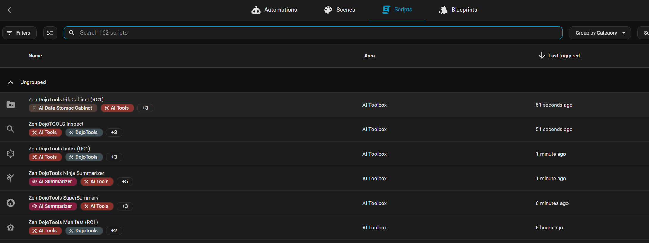

I’m currently on over 200 automations and over 160 scripts and so far, so good. I haven’t gone COMPLETELY crazy - yet. (just mostly)

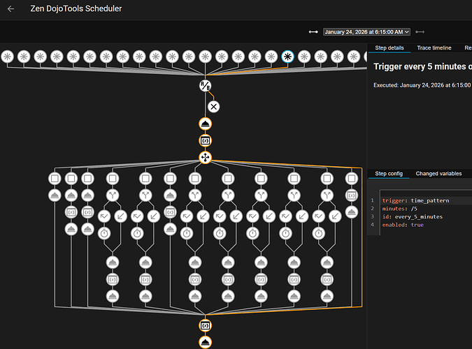

I 100% disagree with this one sorry ashai.but I understand why you’d say it. For my setup it actually makes things easier. I see a trigger. Fired script A with these vars. Here’s the trace from A. Otherwise there is not really a difference troubleshooting IMHO now INTENT_SCRIPTS on the other hand… :sunglasses:
