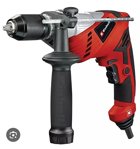

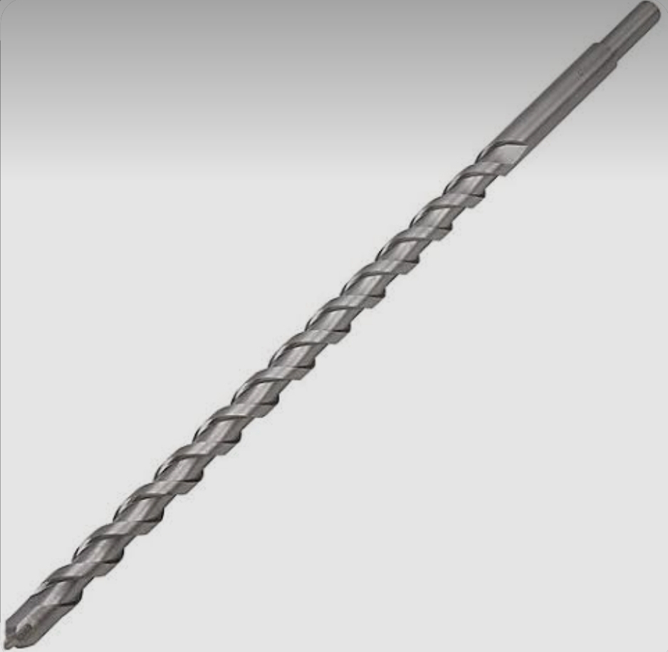

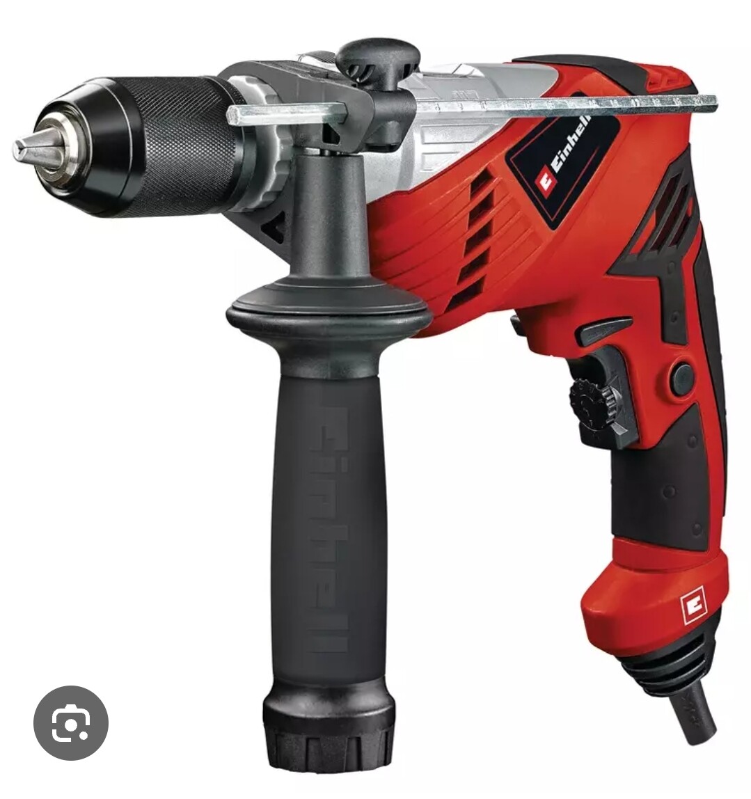

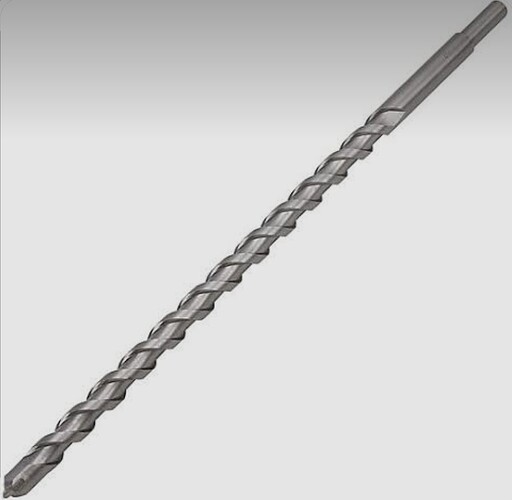

Nothing penitrates a wall like a drill.
Ethernet cable to follow
Multistorey as well? The floors may be even worse, with reinforced steel meshes.
In case you think @Spiro is joking: This would likely be the most reliable option. I gave the same advice to a friend that had WiFi issues at home in a house like this.
