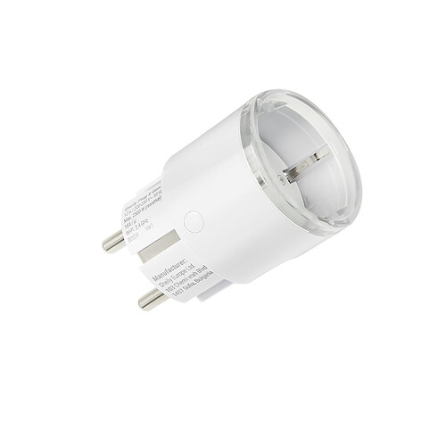

With no other protocols than wifi I’d stay away from Tuya and buy Shelly.

Shelly supports power consumption, energy, and a lot more (which I have disabled), see
