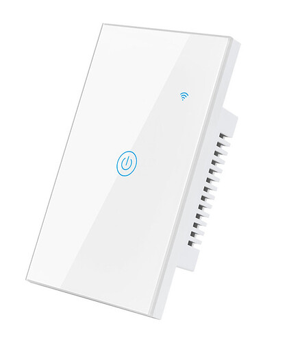

I bought recently Athom ESP firmware smart switch, Connected to Home Assistant without issues.
The main issue is the glass faceplate. When I tried to replace the existing switch, it doesn’t fit. Without altering the in-wall box and wiring I cannot simply replace the old switch.
is there any other out of box switches I can use, compatible with Home Assistant without re-flashing firmware.
