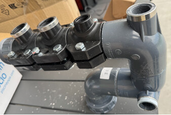

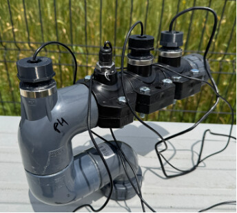

In my case, I didn’t have enough space on the main pump pipe to install four standard saddle clamps. My solution was to extend the line by adding a curve using PVC elbows with specific threaded outlets for the probes:
• Elbow with ¾” outlet (for the pH probe):
Product link
• Elbow with ½” outlet (for a temperature probe used with Loxone):
I also installed three collars:
• One ½” clamp for a temperature probe (using this insertion sleeve).
• Two ¾” clamps for the ORP and salinity probes.

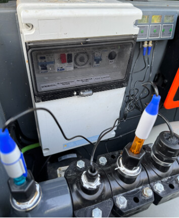

At first, I followed Reunion974’s advice and printed my own probe adapters using a 3D printer. They worked at the beginning, but each time I removed and reinserted a probe, the 3D parts lost their tight fit or broke. It just wasn’t a long-term solution.
Replacing with Commercial Adapters
I switched to ¾” threaded adapters with caps, which are much sturdier and easier to reuse:
Adapter
Cap

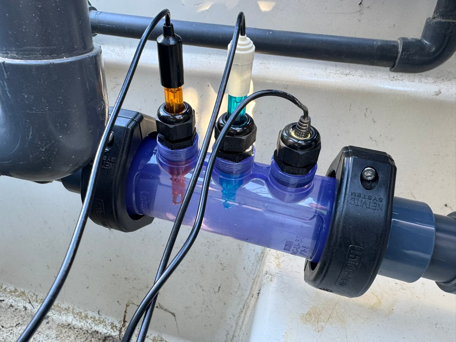

Thank you! makes very much sense. The only question: the cap. Have you just drilled a hole in it, pulled the cable through and then glued? it tight? Or is this a special ring or something? How does it get water tight.
Thanks! Great question — I considered using glue or silicone at first, but I wanted a solution that would be easy to disassemble and maintain.
Here’s how I made the installation watertight:
  • I used a ¾" threaded cap and drilled a hole just large enough to pass the probe cable through.
  • I inserted the probe through the cap, with the BNC connector staying outside and the electrode inside the water line.
  • To ensure a watertight seal, I didn’t use glue or silicone. Instead, I used:
    • Teflon tape on the threads,
    • Rubber O-rings, but these were placed at the base of the threaded collars. This creates a tight seal between the adapter and the pipe system.
This combination has worked perfectly — it’s leak-free, reusable, and easy to take apart if needed.

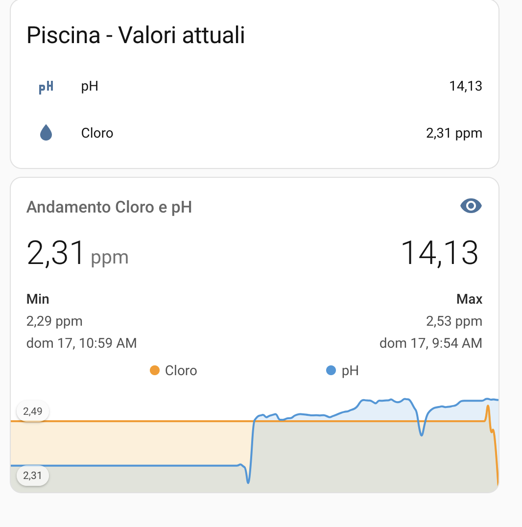

The second sensor (which is the one I use in the frontend and automations) is basically for setting the value to 0 in case the chlorine sensor reports a negative value.

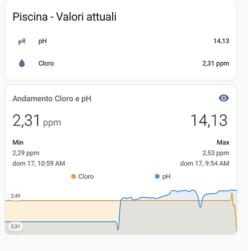

Congratulations on your work! Thanks to you, I was able to integrate the pH-W18 perfectly. However, the readings are incorrect because I didn’t calibrate it. I have some questions about the calibration:
  • Should I calibrate the pH probe with the solution? Should I calibrate the EC and ORP with distilled water?
  • Regarding the pH, did you only do the initial calibration or the 3-point correction?
  • One last question: how often do you recalibrate the probes?
Thank you and everyone for your time!

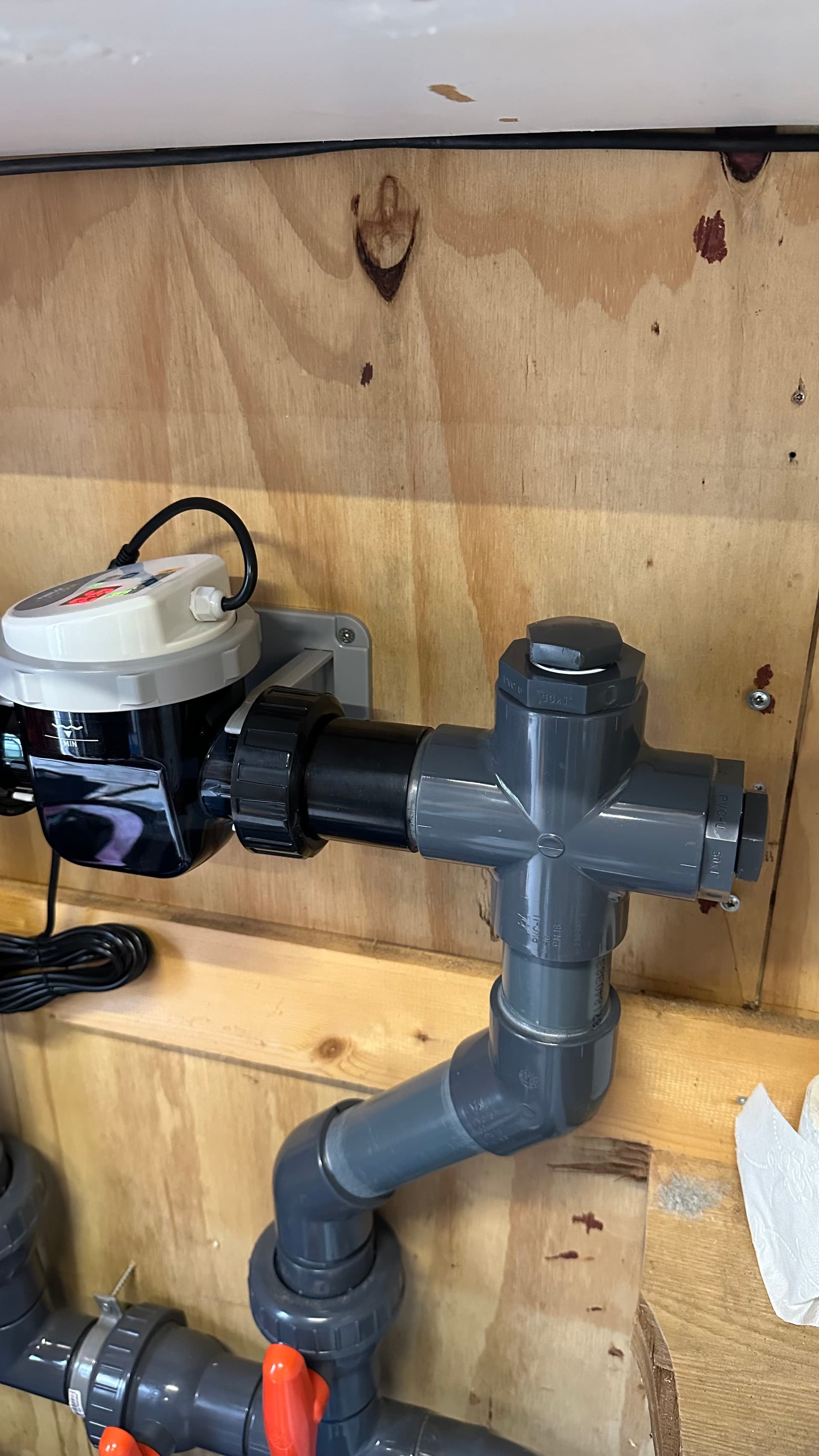

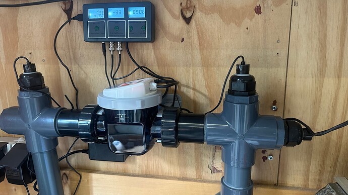

I’ve also implemented my Yieryi 8 in 1 solution with probes into the tubing of my swimming pool. I’ve been able to make it in such a way that it’s removable and water tight without and 3D printing and out of stock components.
I’ve gone for 1" wart for electricity boxes but it perfectly clamps the probes.
For the ones in the Netherlands, this is what I’ve used.
https://www.elektramat.nl/hummel-wartel-1inch-hsk-k-zwart-1209100171/

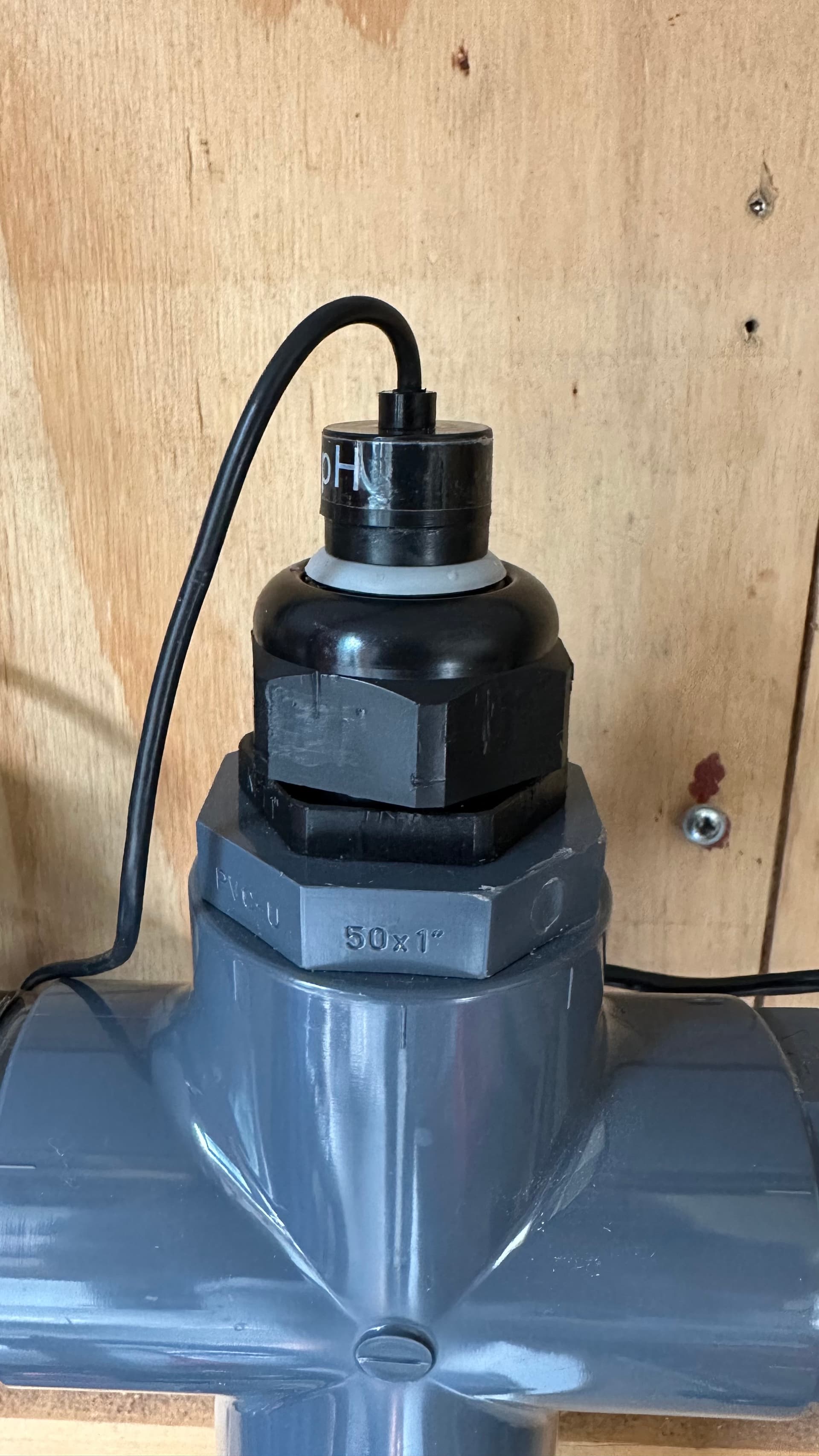

This is also very good and clean solution
Hidroten
Porta sondas de pH / Redox
No need for any 3D printed part
