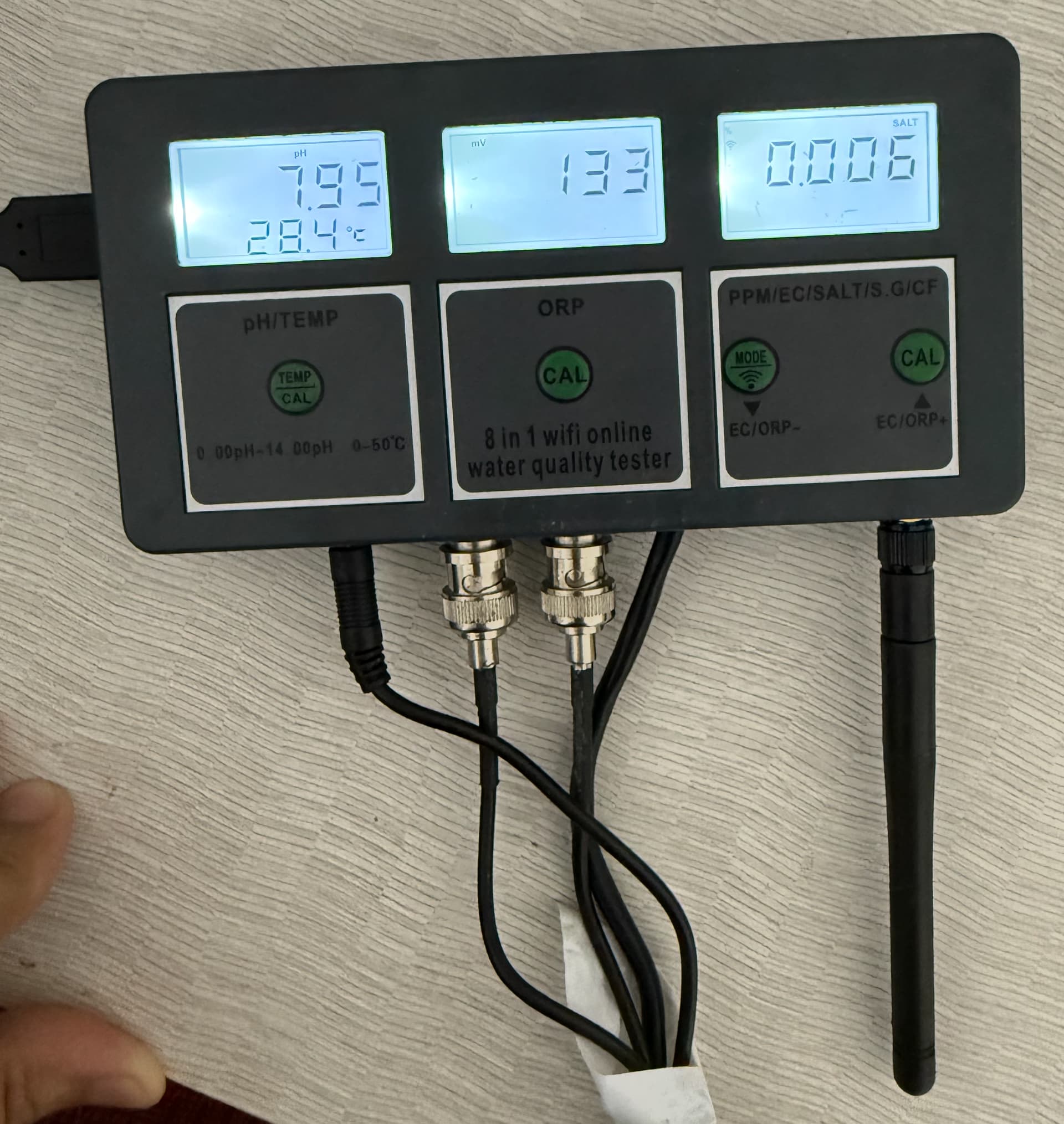

Hi Yuanca, after spending my summer setting up my system, I stumbled on your post! I have the same chemical tester which has worked great for 3 years now, and wanted to replace the pH and ORP probes this year. It looks like I ordered the same as yours on the picture, and the ORP works great for me, but I can’t get the pH probe to read (value does not change). Did you need an adapter or modify anything in the tester itself for yours to work?
Also would love a link to where you got the saddles from. I 3d printed mine and after a huge amount of filament for print troubleshooting and a crazy collection of washers to find the right fitting, it is sort of ok but I have a feeling it won’t last more than 1 season, so I’d like to replace them for next year.

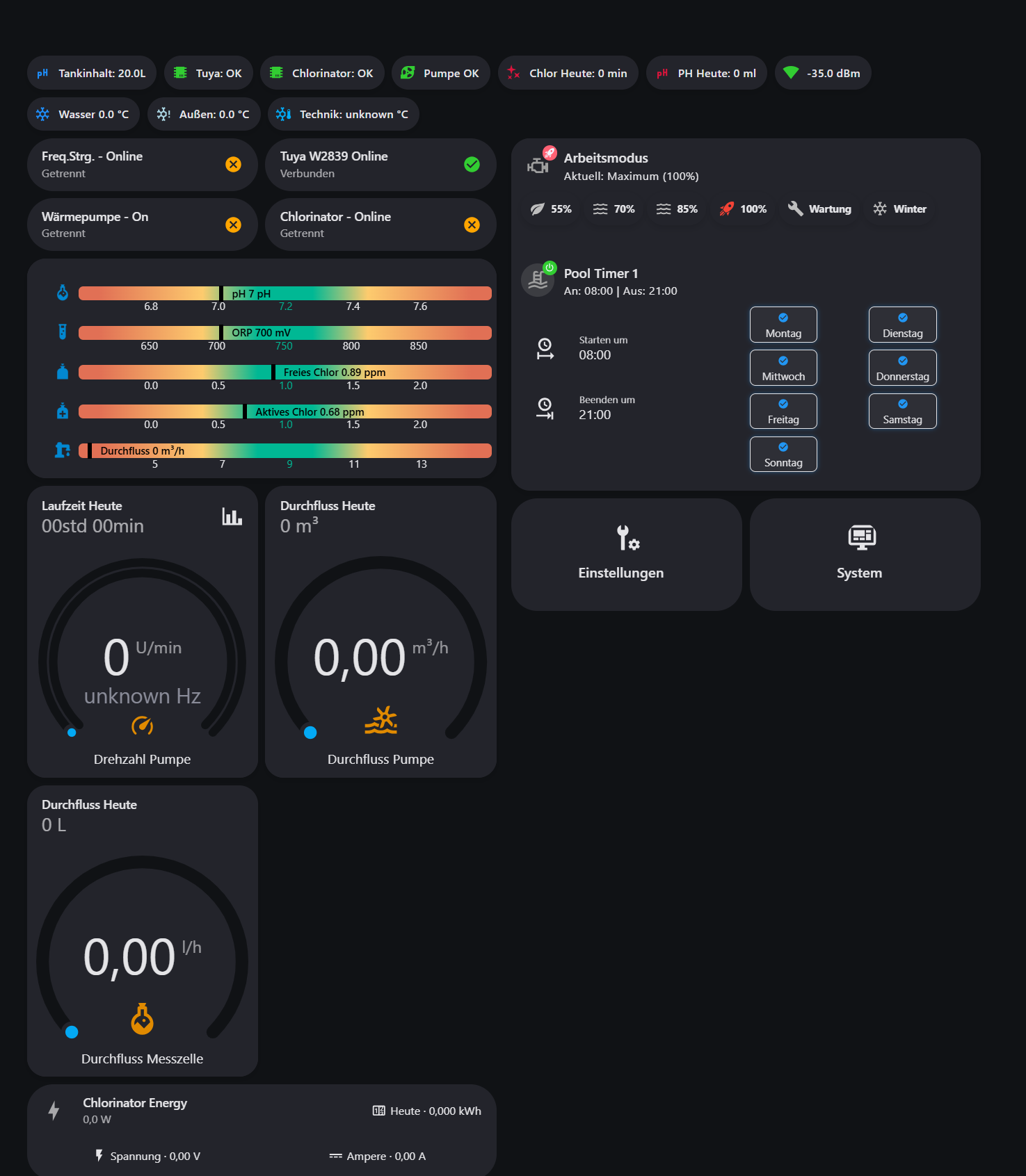

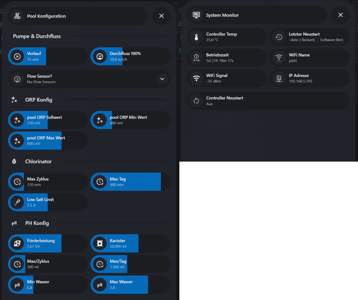

Hi guys,
Just wanna share my integration with the W2839.
What is it?
The tuya W2839 is read by an ESP32 via uart and controlling my chemistry.
  • PH suspension
  • poolpump frequency (thru a china modbus capable frequency controller)
  • chlor generator (salt) via a h-bridge 24 Volt connected to my Zodiac LM2-40 Cell
  • Controlling my heatpump via modbus (still in progress)
Featuring:
  • tons of saftey conditions
  • Workmodes like power saving (55%) and winter (frost-watcher)
  • dynamic timer
  • Adjustable settings like target ORP etc
  • Low Salt notification (measured by ampere)
  • providing tons of logs in the log output
  • all logic inside of ESPHome and can run independetly from internet and home assistant
I started this project quite small and it became a sort of hobby during the time.
I mainly started it in my native language (german), so kindly do not complain but use google translate instead :wink:
If you like the project, you are using it for your own or you are simply rebuilding it, let me know if there are improvements needed.
Cheers

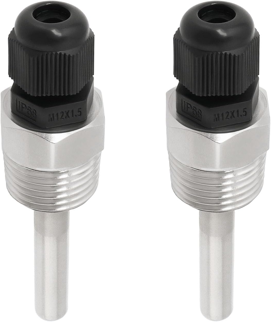

For the temperature probe I used this:
I didn’t replace the original probe. What I did was use a 1/2” immersion sleeve to insert the original temperature sensor inside.
This way:
• The original probe is not in direct contact with the water
• It is inserted inside the sleeve
• And the sleeve is what gets threaded into the installation
This way you avoid passing cables through the plug or doing complicated sealing.
