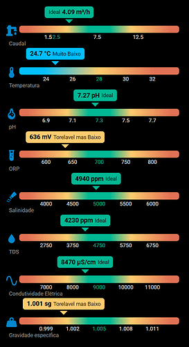

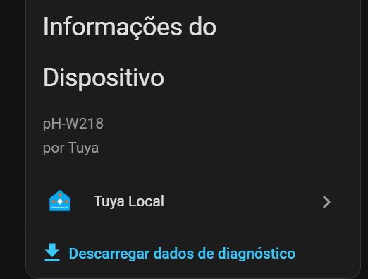

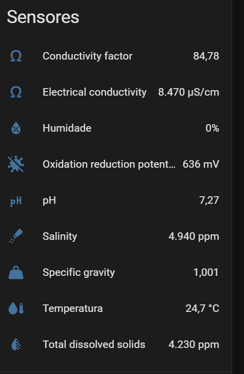

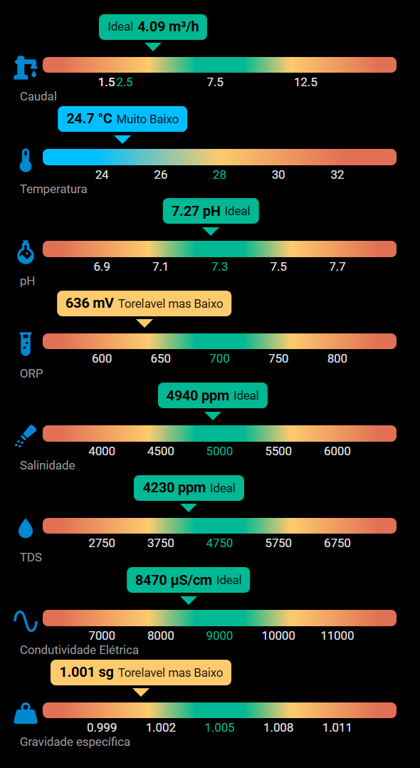

pH-W218 via Tuya Local
BUT (yes a but!!) use others ORP and PH probe, the original ones aren't very accurate, the values ​​were very inconsistent

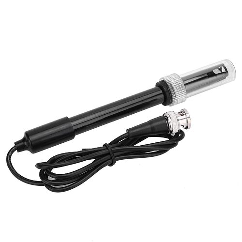

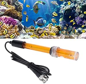

Which sensors did you use?
hello
this ones, with the 3d Printed adapter (as post above)
ORP
PH
