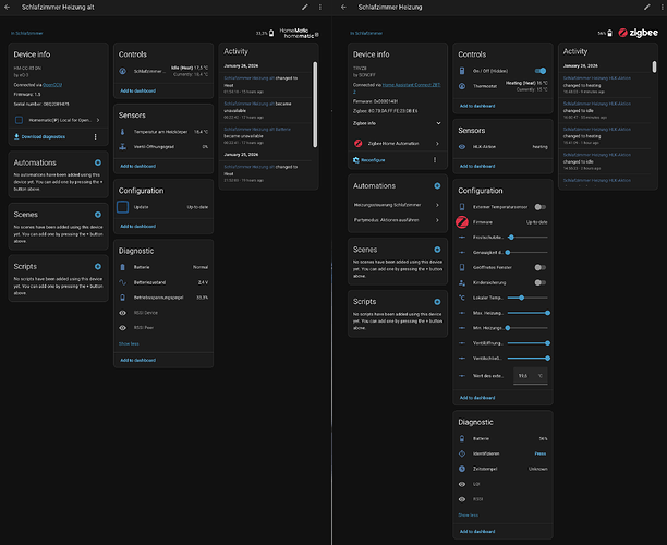

For anyone who’s interested, here’s a visual comparison of the entities provided by a Homematic HM-CC-RT-DN and a Sonoff TRVZB:
(a HmIP-eTRV-2 exposes the same entities as the HM-CC-RT-DN)
The actual valve opening is the “Ventilöffnung” Entity in your screenshot. The Sonoff is stupid. With AHC you can configure the PID / Valve Opening dynamically. In your case it’s 100% open. Without any logic it only switches between 0% and 100%.

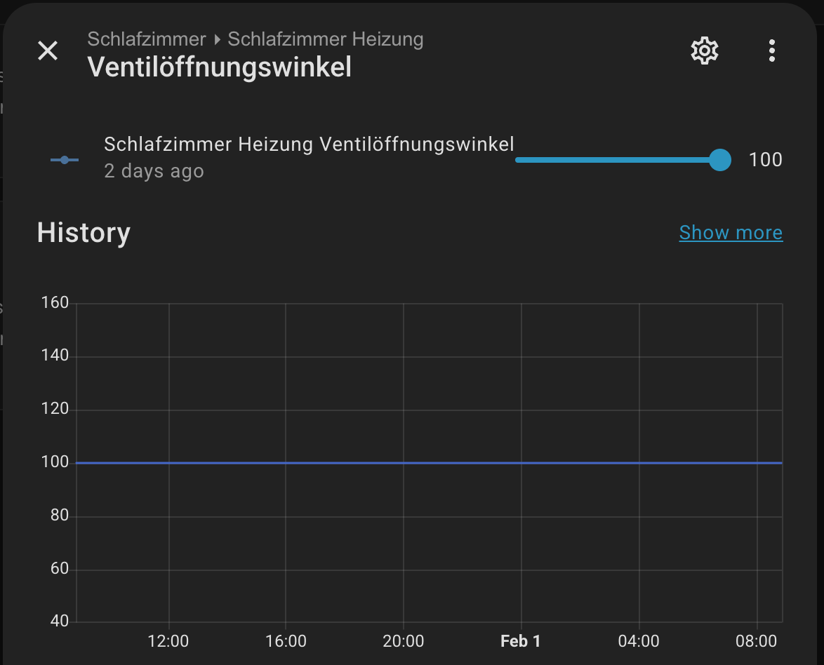

For my configuration both Ventilöffnung… (german for valve opening) are staying at 100. One is called “valve opening angle”:

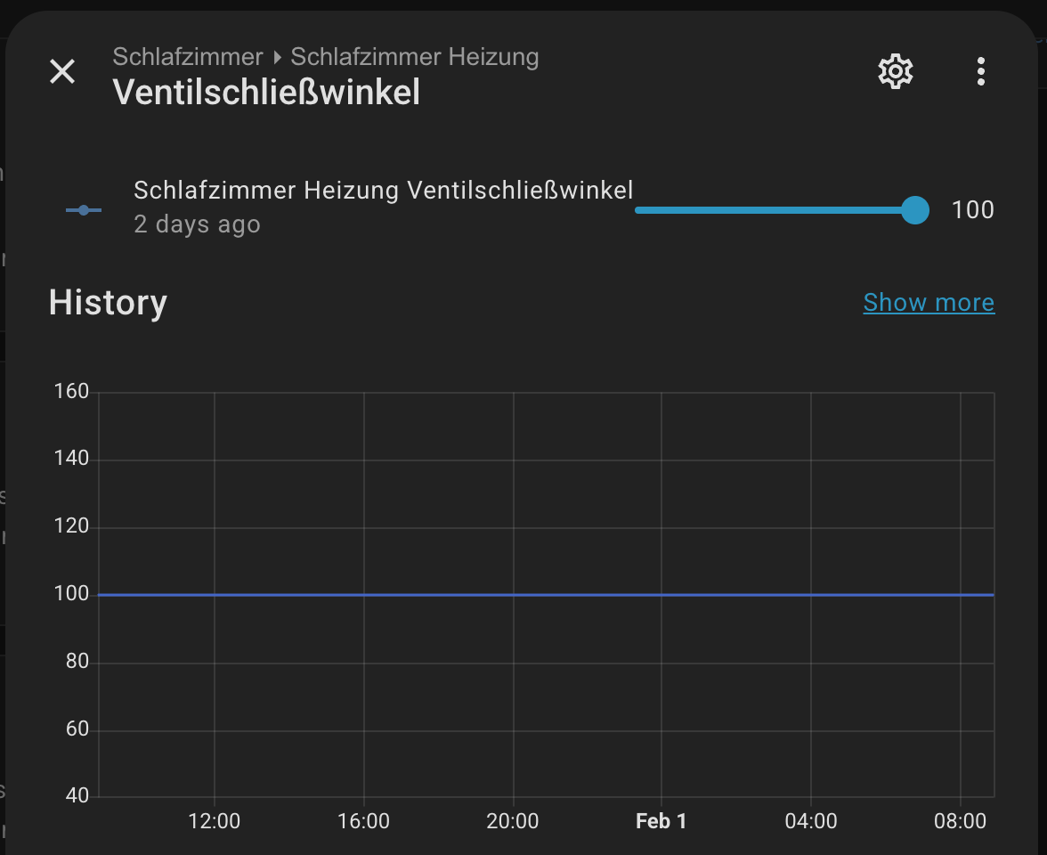

and the other one “valve closing angle”:
If this is the actual opening of these should have changed at some point, since heating is taking place in the moment (and 10 hours ago it was not).
My best guess was that these entities are the minimum and maximum valve opening. But still, both values staying at 100 doesn’t make sense. Maybe I got it wrong?

If the thermostat heats, means the target temperature is greater than the local one. The valve opening is set to this value. Vice versa if the target is reached the valve closing value is set.
In your case:
Target: 20°
Local: 19°
HVAC-State: Heat
Valve Position: 100%
Target: 20°
Local: 21°
HVAC-State: Idle
Valve Position: 0%
That’s why I’d implemented a logic to slowly close the valve opening value if the target meets the real world temp.
