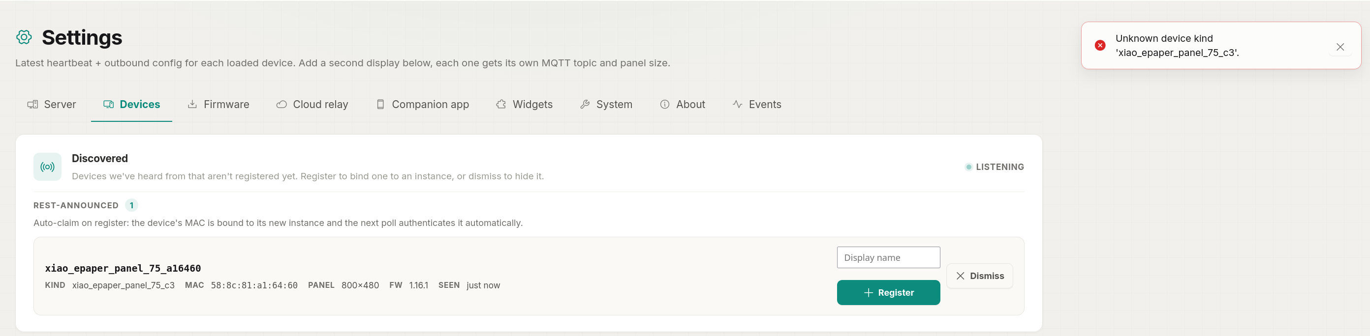

Happy to help and now I’m reaching an other issue. I have configured the display through the captive portal in Wifi to get url of Tesserae on my HA. It shows up in the app but impossible to associate it:

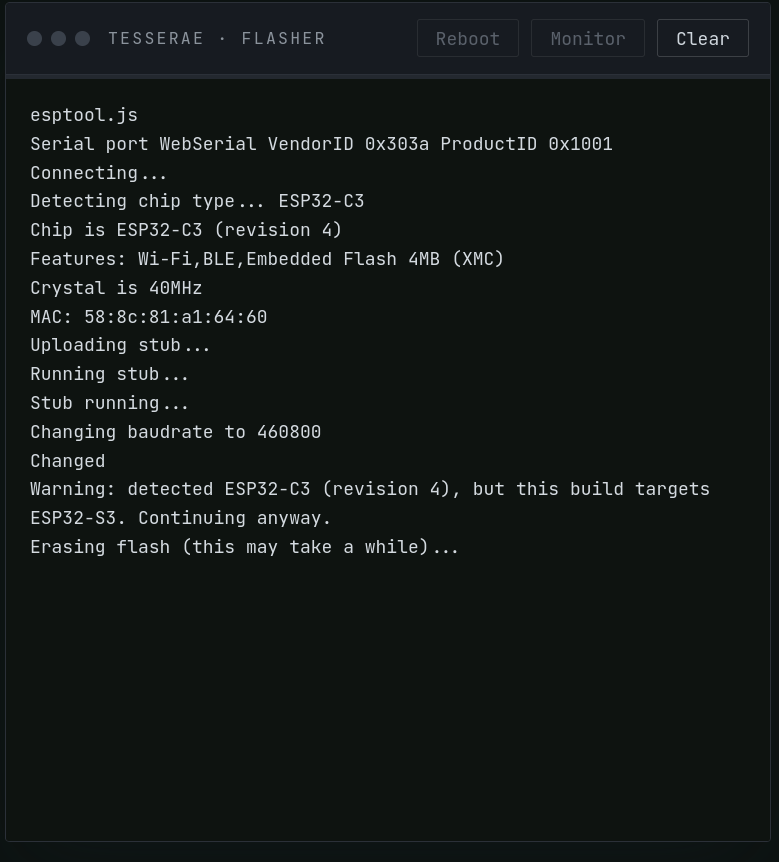

Also during the flash there is a warning message that should not show up stating I’m flashing an S3 firmware in a C3 device:

The S3 warning is a packaging bug: our release pipeline labels every image as ESP32-S3, so your C3 build got shipped with the wrong chip family in the catalog. The flasher was right to complain. The bytes it wrote were correct, which is why it booted, but I’ll fix the label so nobody else sees that.
The association failure is the server not yet knowing this panel. The display is reporting itself as a new hardware type and there’s no matching entry on the Tesserae side, so it registers but can’t be paired. That’s a server-side addition rather than a firmware one, and it’s next on my list.

The server side is live so once you update (use edge) you should be good to go.

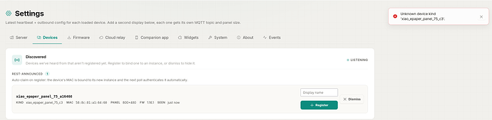

The edge version 0.318.2 still is doing the same as release version, it discovers display but when I try to add it it states it’s an unknown kind.
check HA for an update. the docker container must still have been updating. edge should now be on v0.319.0.
