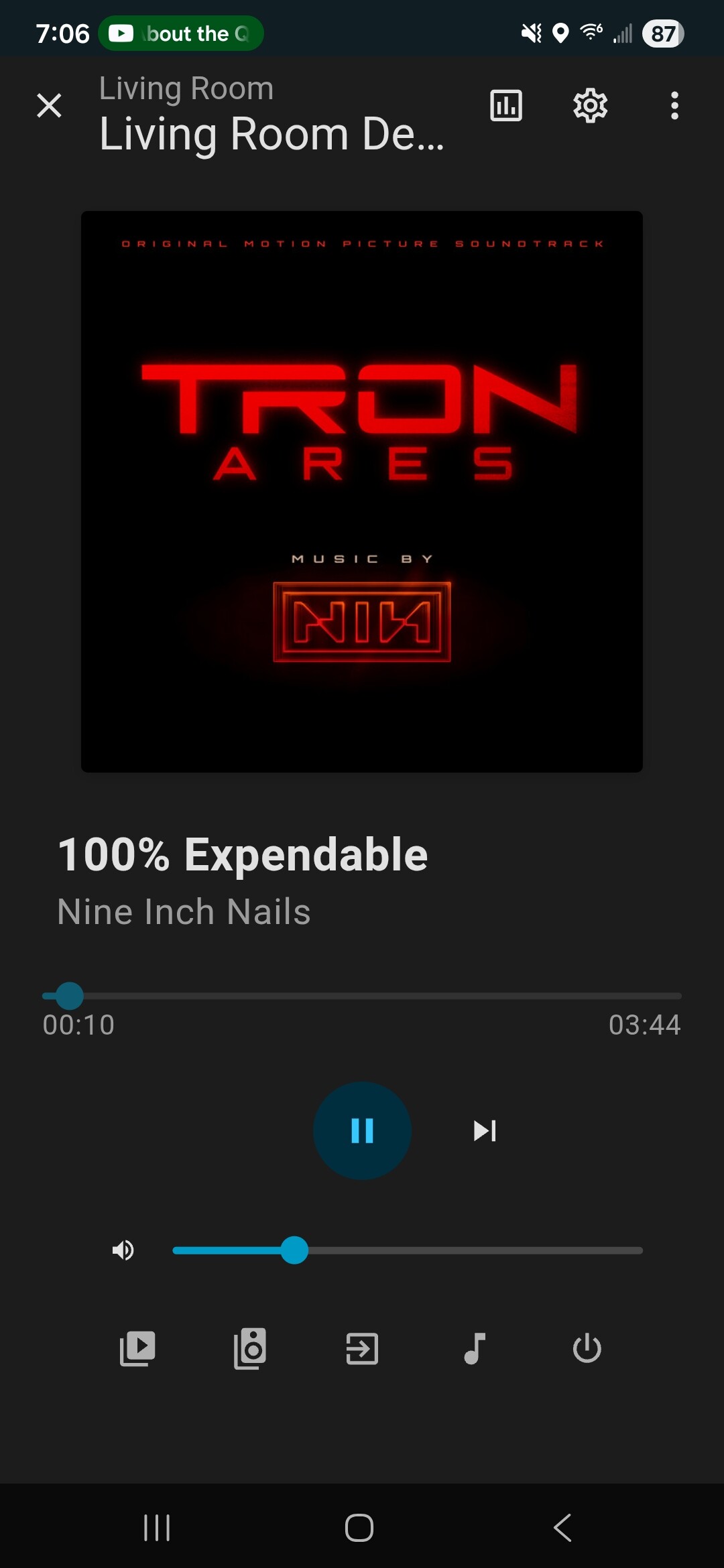

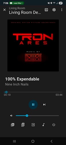

Friday is surfing media all around my home because exactly what you hit on. I’m working hard to make my stuff present as exactly that. Use Homeassistant features to force your stuff into behaving like default stuff then the built-in tools and generic tools from the community take over. When something (like the media panel on my hot tub) doesn’t I force it into that mold using a universal media player. Things like template entities and universal media players can glue together actions and status to simulate a coherent entity or device…

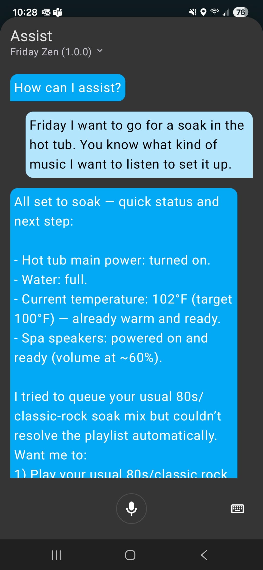

That means so I can literally tell Friday to pause the TV, switch to the Denon and send X Spotify Playlist to it then fire up the jot tub audio and join the speaker… Or in shorthand. Friday, I’m going for a soak, you know what I want to listen to - set it up… The ai knows the intent is music in the hot tub and then can figure it out because it knows default tools.
(And I put these in here so you guys know I’m not BS-ing you. I was conveniently about to check Chem and the spa is now running with Motley Crue playing out back.)
