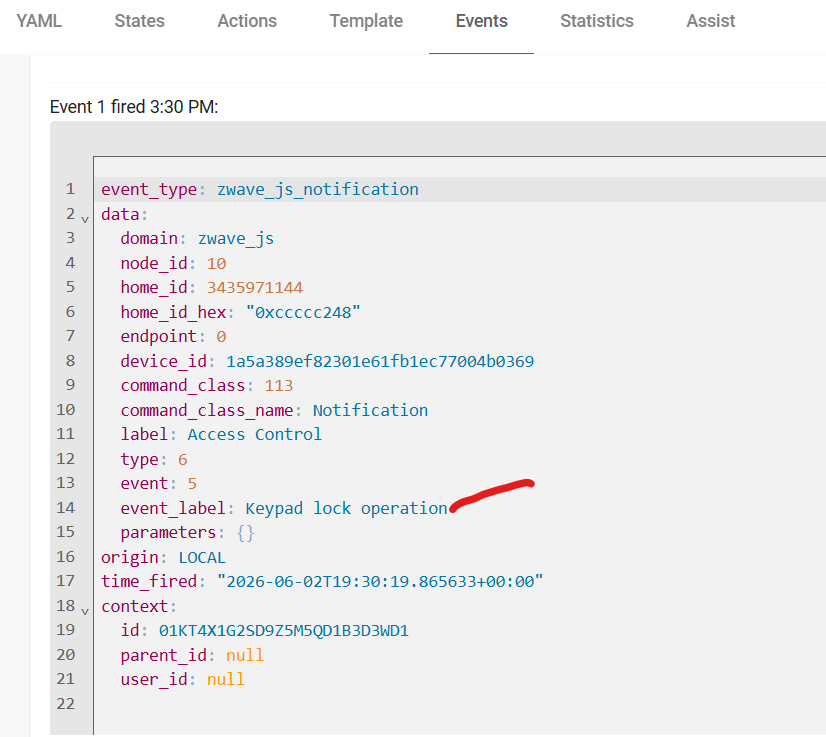

Thank you! I was not aware you could look into this from a zwave_js notification perspective. Good to know! I generated a "Manual lock operation" and unlock, then using the keypad outside generated the "Keypad lock operation" shown in the screenshot.
What I don't see how to do is use the "Keypad lock operation" event as a trigger or condition in an automation.
That "Keypad lock operation" event is exactly what you want for the arm side. You use it as an Event trigger (not a state trigger). In YAML:
- trigger: event
  event_type: zwave_js_notification
  event_data:
    device_id: 1a5a389ef82301e61fb1ec77004b0369
    event_label: Keypad lock operation
The event_data keys just filter the event: device_id pins it to your lock, and event_label to the keypad-lock case. (In the visual editor: add a trigger, pick Event, set Event type to zwave_js_notification, then put the event_data block in.)

Now flipping the thumb-turn from inside fires "Manual lock operation" instead, which this ignores, so it won't arm with you in the house. The sitter locking via the keypad on the way out fires "Keypad lock operation" and arms it.
One tip: the event_label text works, but if you want it bulletproof against any wording/translation changes, match the numbers instead, same result:
    event_data:
      command_class: 113
      event: 5
(113 = Notification/Access Control, event 5 = Keypad lock operation.)
