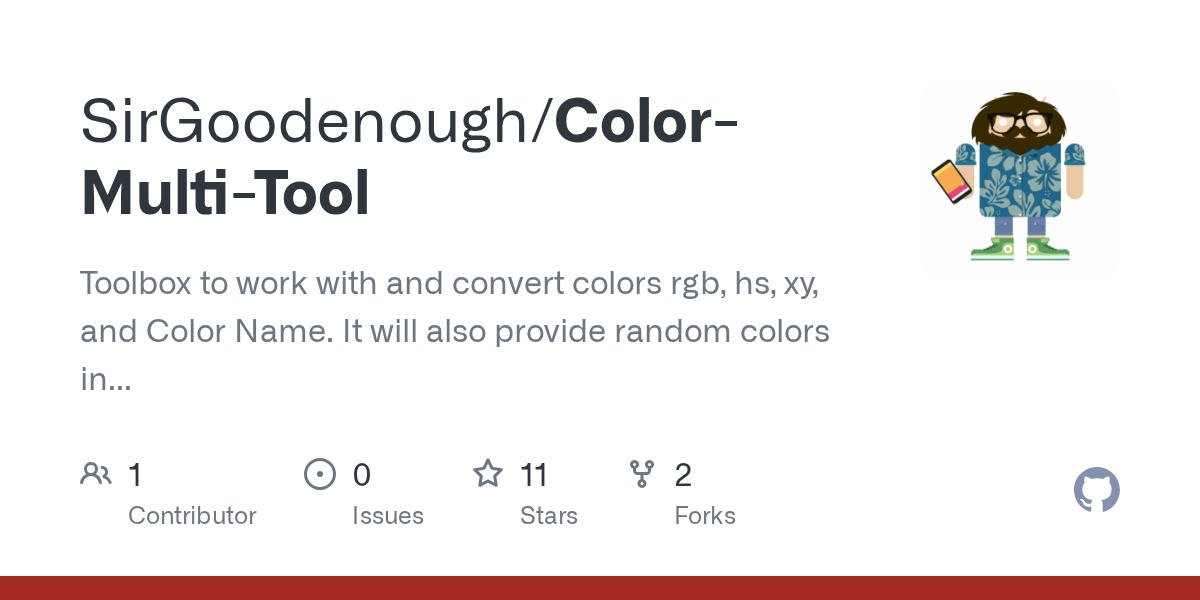

Along the line that Drew draws, my color template macro could easily be adapted to do this. Most of the code is there.
feels like magic code if I read that :slight_smile:
