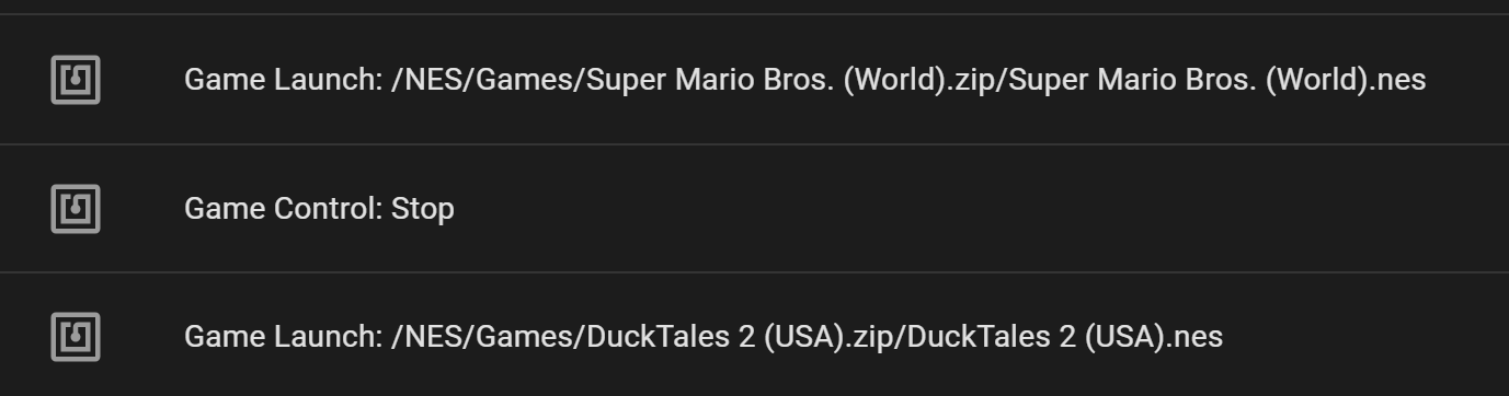

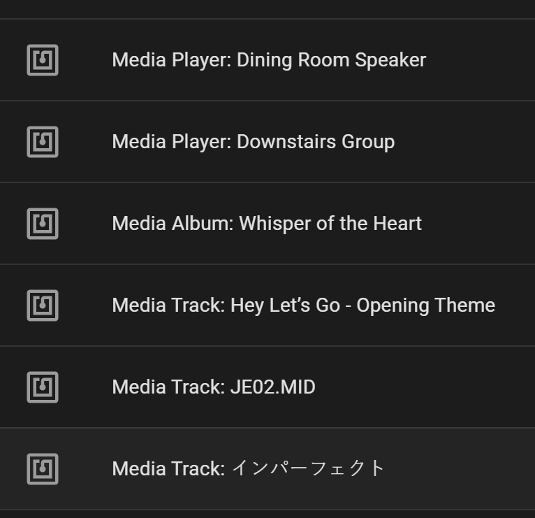

I name each tag with a string action and parse it in my automations:
The important piece is I use the Tag’s “Name” field rather than doing it all in software.
I have one automation for games and one for music, and they both use the device ID to determine which device to target.

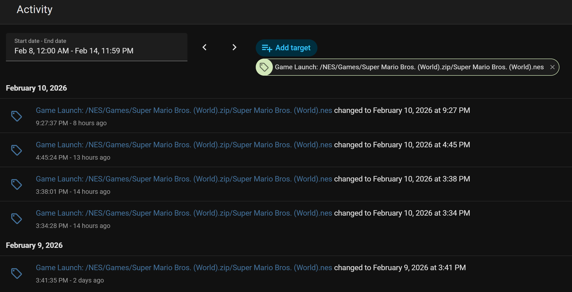

1. Log Visibility
Using the “Name” gives you more visibility, especially in the Activity Log:
I can still name the Tag to make logging better, but that requires duplication.
