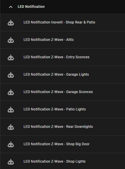

I use a combination of Categories and naming conventions. For instance, I have a bunch of trivial automations that set the color and on/off of the notification LEDs on my Z-Wave and Zigbee dimmers/switches. I put them all in the category of LED Notification, and each one’s name begins with LED Notification.
I thought that is what categories were added for, sorting automations.
I have tried both prefixing and categories.
Categories are nice in that they allow me to “fold” categories that I want to hide in the list.
However they are UI only (not saved as part of the automation itself) so I think I am going to use both.
